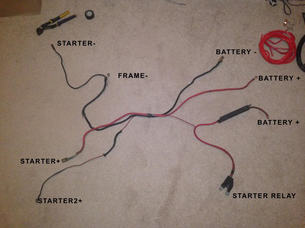

heres the harness i pulled out. i need to know
-out of curiosity does ford sell harnesses at dealership?
-what is best way to redo the frame ground? bolt is practically rusted solid with frame along with connections, bolt or previous hole is not usable.
this is my plan. I am going to leave alternator connections for the time being.
I got battery terminals, 0gauge wiring and 0gauge connections from KnuKonceptz, should be here saturday.
-could someone let me know if it is ok to use some 8 gauge wiring for the starter relay to starter, as marked with a thinner line on the pic, i have a lot of it, nice quality, and the original wire is considerably thinner.
- is the strange shaped rubber connection serve any purpose? prevent current jumping between? can i use normal wire/connection with decent insulation?
-the other connections i plan to do not pictures are engine block to firewall grounding strap, and a frame to chassis ground strap that i found to be broken clean in two, this actually broke several months ago so it is not the immediate cause of the no start..
thanks in advance for any help before i get started on saturday
EDIT-ok realized its not really a harness.. just separate connections happen to be connected so ignore any harness references..

Rather then make stuff up I'd just order it. Rock auto carry's almost all the main wiring..
