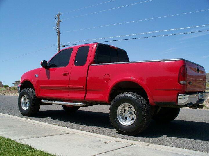

This Is pretty much how someday I want mine to look
