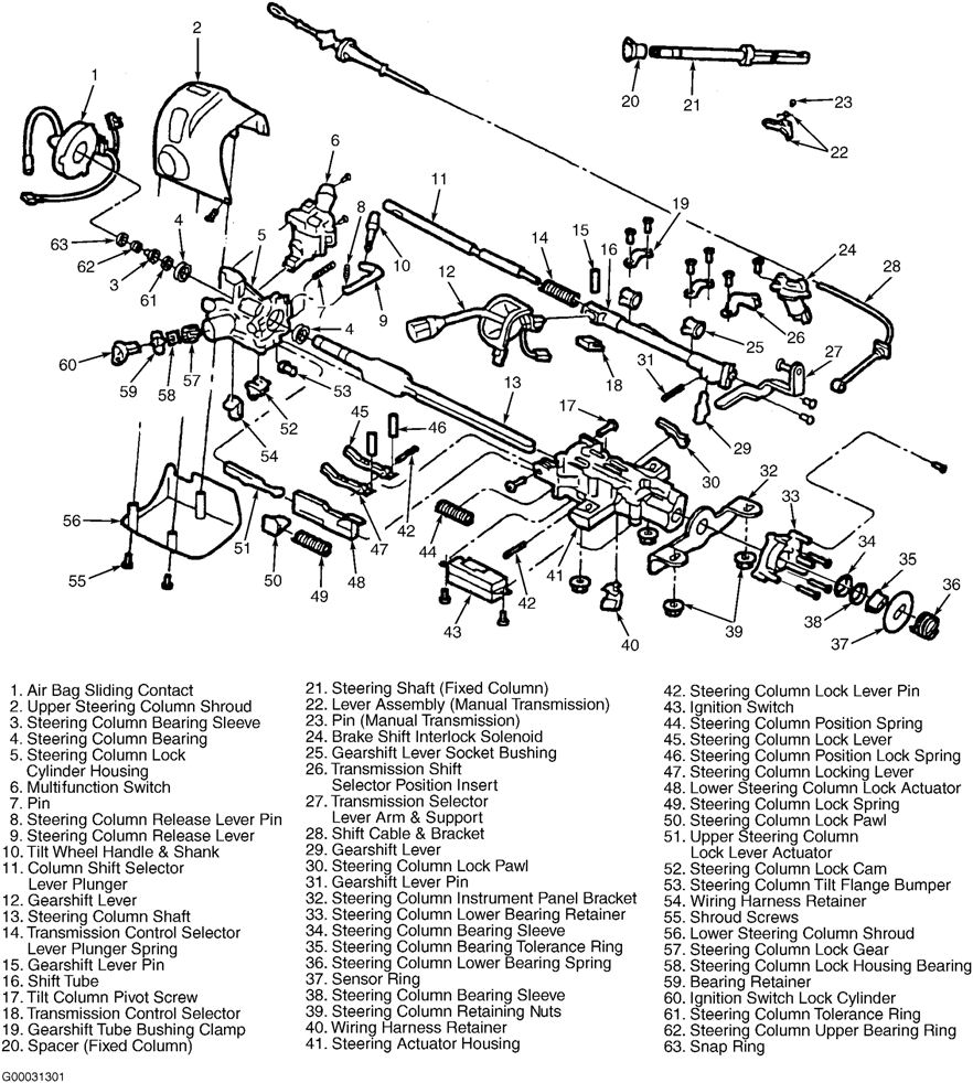

OK, I found this. From the description of item 18, it seems to be what I am looking for. It just does not look like it (I expected it to have some sort of teeth or something). If it is, then I am thinking that item 15 might be the pin I found. I looks like that pin might be what hold in the shift lever though. I'll tear into this weekend, but if what I am thing is correct then: Item 11 slides into item 14 which slides into item 16 and held in there by item 15 which rubs on item 18 and that is what "locks" it into a specific gear. Not sure if anyone can follow that thought enough to confirm it.

Yes, that looks to be the one I was talking about. The one on mine backs out a little bit every so often and I have to push it back in.
