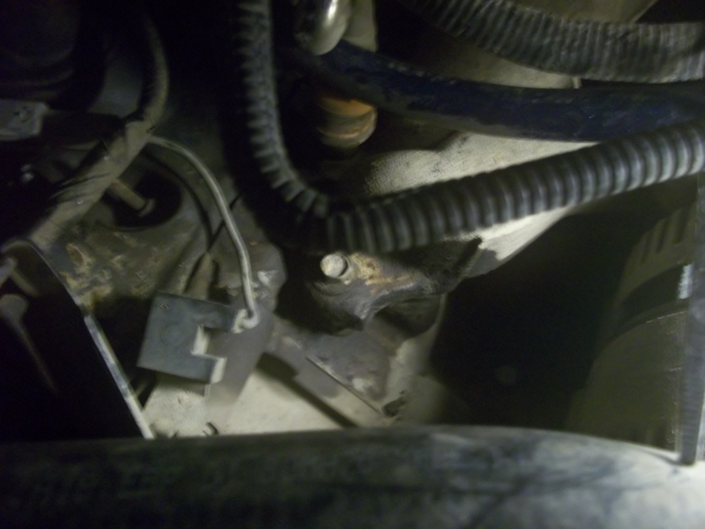

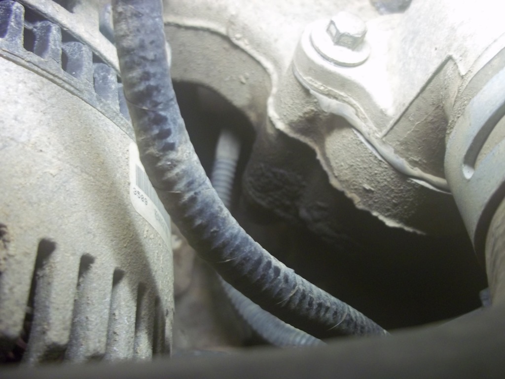

i see these 2 spots at the mounting flange of the intake

Someone used rtv sealant instead of a gasket and has been into the thermostat at one point or another. Another sign there may have been an overheating issue in the past. That looks like a minor leak and would not cause the conditions you explained. Are you getting any white smoke out the back? Loosing coolant?

no codes at the moment ...and the thermostat i have replaced , and it does smoke but not verymuch ...the leak in the front is the only one i can see so there could be others...also when i unhook the green vac line that hooks to the egr it runs better but still can tell buy the sound

and just looked at what i can see of the rest of the flange and it looks the same like wet but not wet with dirt/sludge build up all the way around the lower intake flange...can i reuse the stock gaskets , or are they not like the newer ones ,,cause i can tear down the motor and see if the gasket is broke or damaged somewhere..cause to me it seems like a vac leak cause when i give it some gas it acts like not anuff gas or to much air

i have my own scanner and like i said before there is no code , also i have seen blown head gaskets and there is no water in the oil or pouring out the muffler ...coils check when cold and hot spark plugs pulled time after time and nothing wrong with them , like i said it acts like a vac leak and as shown the intake show's a leak from somthing

well did a search of pic anf found that im no the only one with the leak on the intake like that so im pulling the intake
