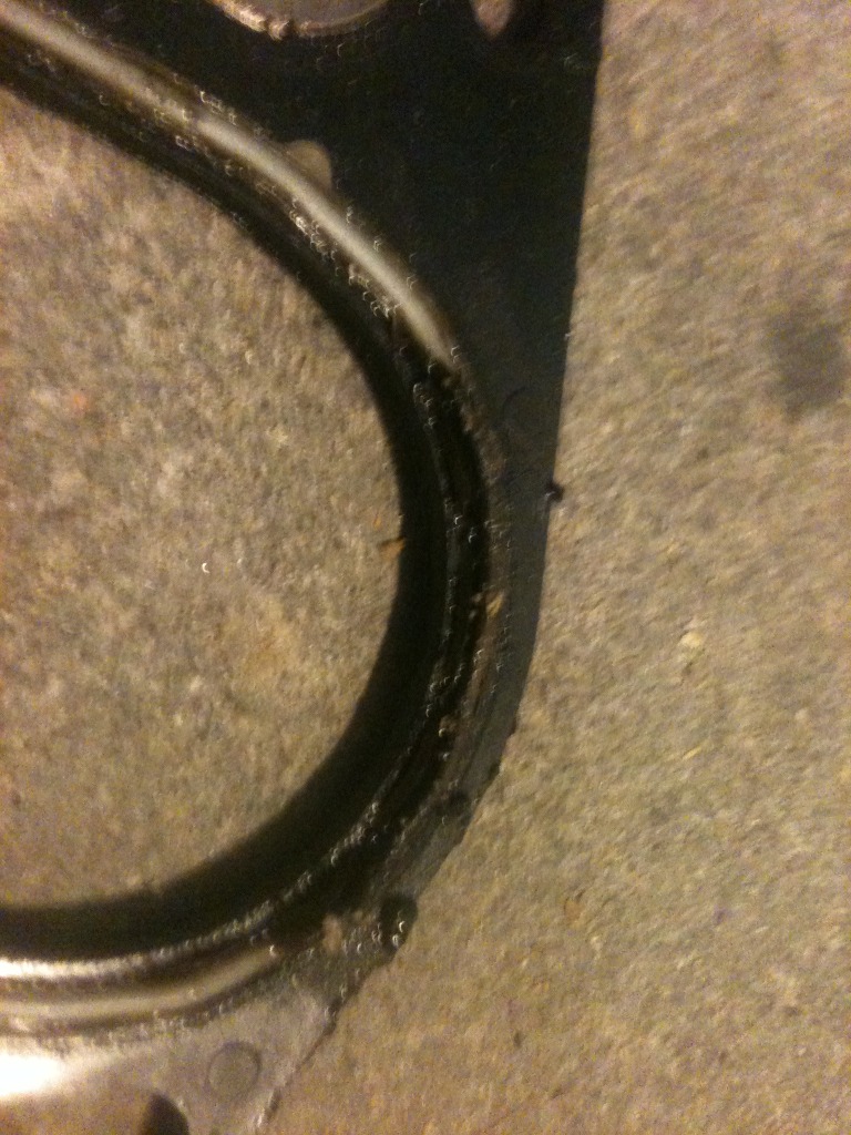

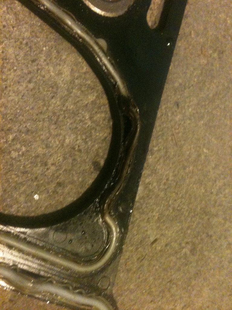

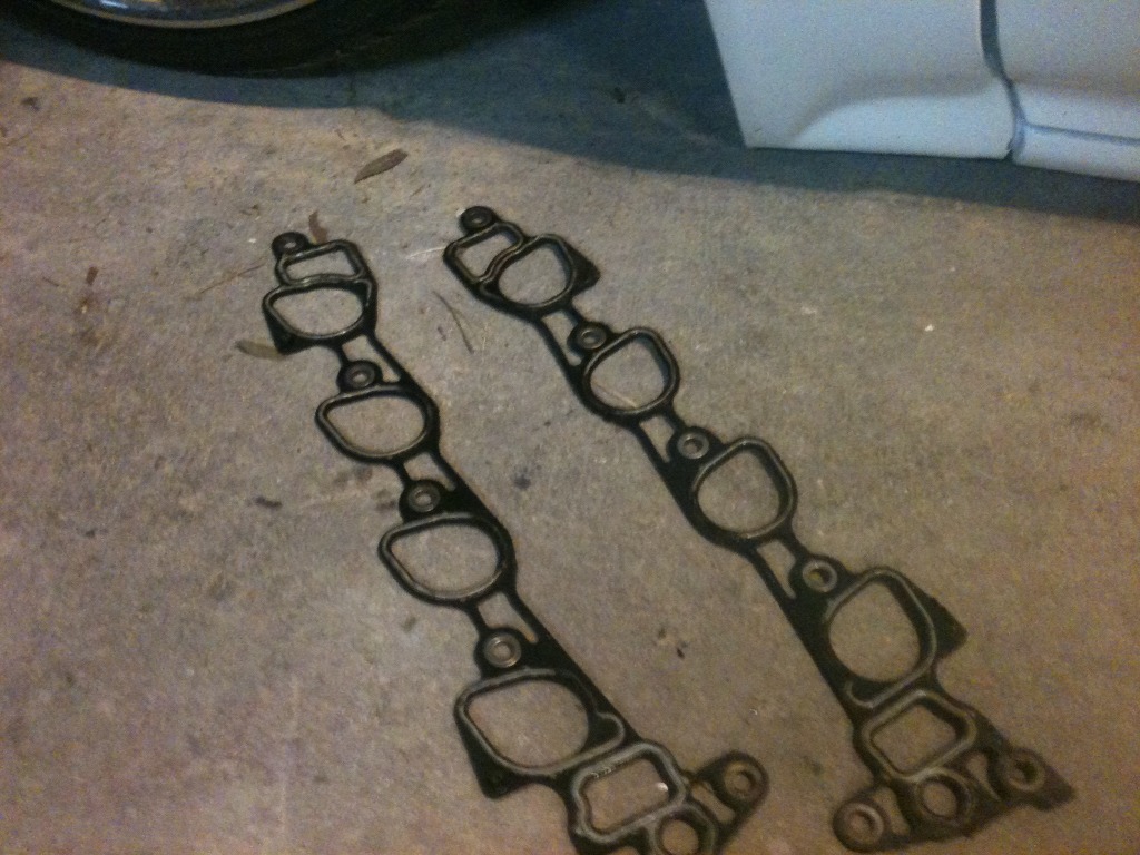

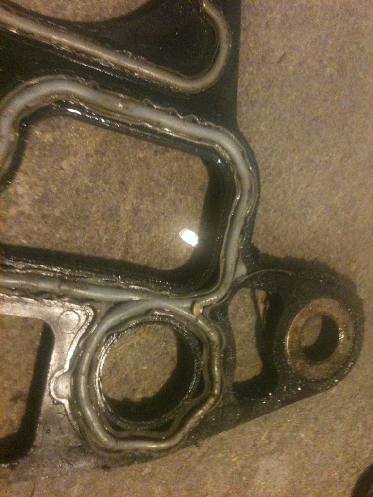

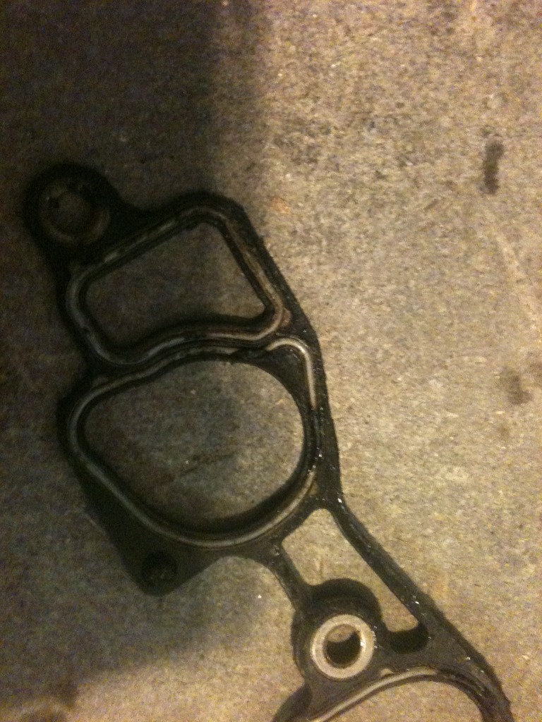

the leak is on both sides on the intake far away from the thermostat housing ..also its not ust rtv **** ..they say to use both when replacing one...so please tell me how the leak on the front right of the motor is leaking on the left rear of the flange.also shows what yo know my intake is alum and the 2nd part under the intake connected to it is plastic

Nobody can even follow what you are doing or what you have done. If you want to tear into it and start replacing more parts than you already have then go ahead. You have been given advice to test for hydrocarbons in the coolant which you havent done along with a compression or leak down test. Those tests can tell you a lot of things or help eliminate other possible issues. The key thing for me here is that you said every time it starts to stumble like that, it over heats..."it smokes a little bit" and doesnt misfire until it warms up. Sounds coolant related to me. If you have an external leak at the manifold gasket then change it for good measures. The only pic I saw was the pic of your coolant elbow at the thermostat.
BTW, no coolant passes through the lower intake. 99 was the only year of the aluminum intake manifold in the 5.4L PI engine. Once they went to composite they were one piece. The composite intake manifolds were known to crack below the crossover which would cause a leak and need replaced.
Also, if it is running better when you unplug the egr, maybe you should clean the throttle body elbow and egr passage on the back side of it while you have it off to change the manifold gasket. And no, don't reuse your gasket.. new set that included everything but the IAC is around $65

125 psi comperssion is not so good unless you live at 7000 feet. But you got it running your way. If all were 125 you uniformally have a weak motor, unless you live at 7000 feet of altitude but it will run until it quits again for good. Thanks for posting your compression readings. You now know the motor is perty worn out. And you have a fix for now. Important thing is the compression is uniform so you don't have a dead cylinder. You didn't waist your time testing it. You know what to expect next. Always take a vacuum reading and do a compression test when you look at tearing down along with a tru oil pressure test next time for the wear at the crankshaft knowledge. We are all here to help theOP, not try to outsmart him. Many, Many probably thousands of years of experience are here to help.
