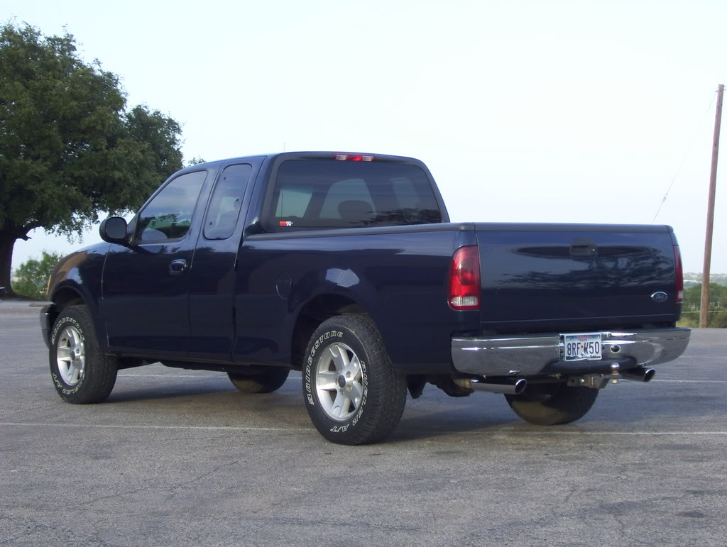

That tailgate looks to be for a supercrew, which will not fit your brother's bed if he has (what sounds like) a supercab (or extended cab for a more generic name).
To clarify things, is this what your brother's cab/bet setup looks like? If so, the tailgate in that link will not fit his truck.

1clean42: Which link? The Harley Davidson one?

Yes, the Harley Davidson one. Harleys only came on flaresides for 99-00 and supercrews for 01-03, never in a styleside (like my truck pictured above). So if your brother's truck is like mine, I'm 100% sure it won't fit.

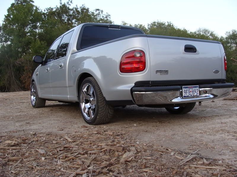

Flare side and supercrew share the same tailgate. (shorter width)
So you're looking for a standard F150 tailgate, or even an F250 tailgate.
Easiest way to identify the tailgate is the detail around the handle.
The "standard" or "styleside" has a long crease all the way across the top near the handle.

The flareside/supercrew has a short dome around the handle.

THANK YOU! This is the EXACT information I have been looking for all along. You rock!
