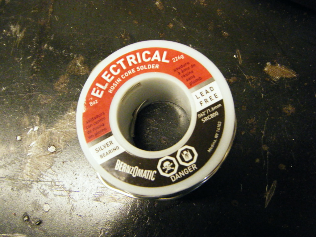

heres my thread on how im doing it. i know its supposed to be 3. but i had extra wire, so why not
solder i used.

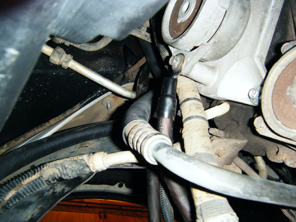

first one i did was the frame to body wire behind the passenger front tire.

both the motor and battery to frame were grounded on the stock location in the passenger side front wheel well.
im not finished because i still need to get the battery to alternator. but that may be a while because i have to take the S/C off to get to it.
