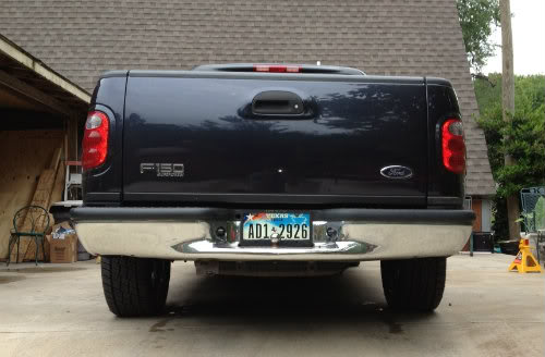

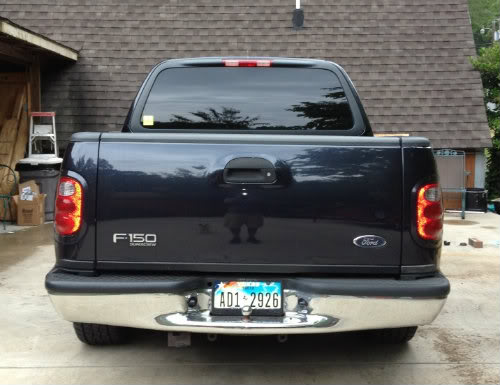

I measured from top of fender to center wheel hub;
Front left: 18"
Front Right: 17"
Rear Left: 17.5"
Rear Right: 17"
Here is the truck on level ground. You can see it lean towards the right.

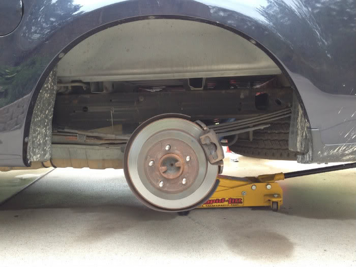

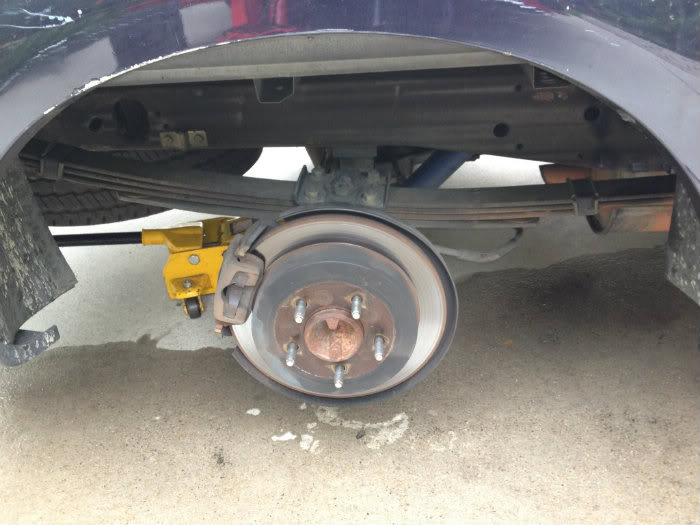

Leaf on right side.

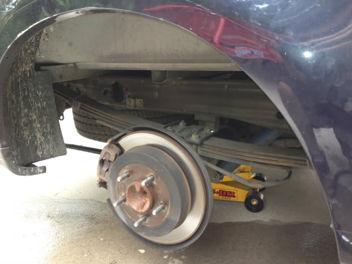

Leaf on left side. Low side too.
Went to get an alignment and the shop advised me to go talk to a body shop they referred. They said it could possibly be a bent frame due to collision, now I did have an accident back in 2005 where a another car hit my left rear wheel at an intersection. It pushed the axle over bending the front hanger. Axle and front hanger was replaced, but don't remember if the leafs were or not. I want to say the truck had that lean from before the accident, but back then I didn't pay it too much attention. Meet with the body shop later and I'll see what they say. Can the truck still be aligned as is? Its my daily driver and not sure if I'll be able to fix the problem right away.

something looks terribly wrong with the right leaf pack by way of those pics. When I blow up the photos, it actually looks like it is missing half of two leafs.... to the left of the brake rotor. hmmm

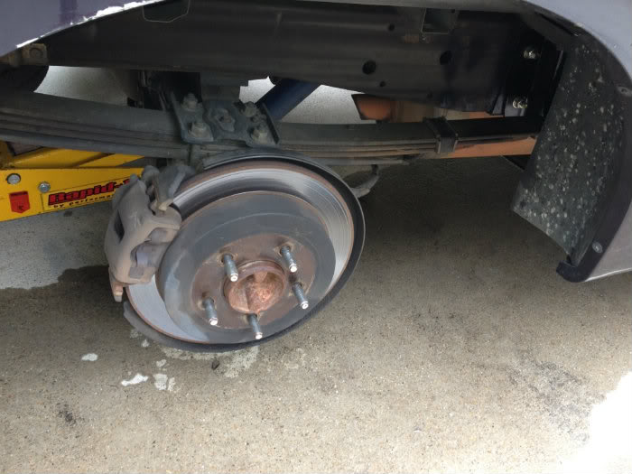

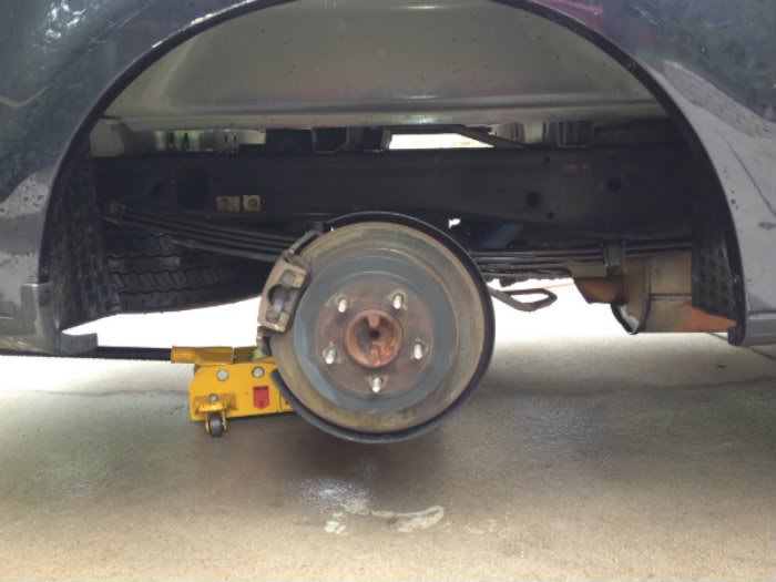

Here are some pics of the right side. Please let me know if there is something wrong with it and if that could be causing the truck to sit uneven.

those pics look better ... and normal, from what I see

Notice how, in the first two pics that the top of the left rotor is positioned to the bottom of the frame rail... while the top of the right rotor is higher

post pics of your shackles and label
Old May 11, 2012 | 01:41 PM
Your pictures are backwords labeled, left you should see gas tank and spare under the frame
Old May 11, 2012 | 01:43 PM
The parking brake cable is decieving my eyes, looks like the leafs is broken

Got confused with the pics in my last post, but now the correct ones are posted for the right side leaf in my previous post.
I think that might be the angle of how I took both pics.
I talked to the body shop and they took some measurements. It looks like the right leaf is compressed more than the right one, measuring from top of leaf to bottom of frame. They recommended replacing both leafs, which is not in my budget at the moment, but will try to soon. I'm thinking that back when I had the accident the body shop might have replace the left side and not the right. I got the idea to move the right side leaf to the bottom hole of the lowering shackle which should raise that side up an 1" or so. Does anyone see a problem with that quick fix for now?

that would be a temp fix, and it will only bring it up .5"
