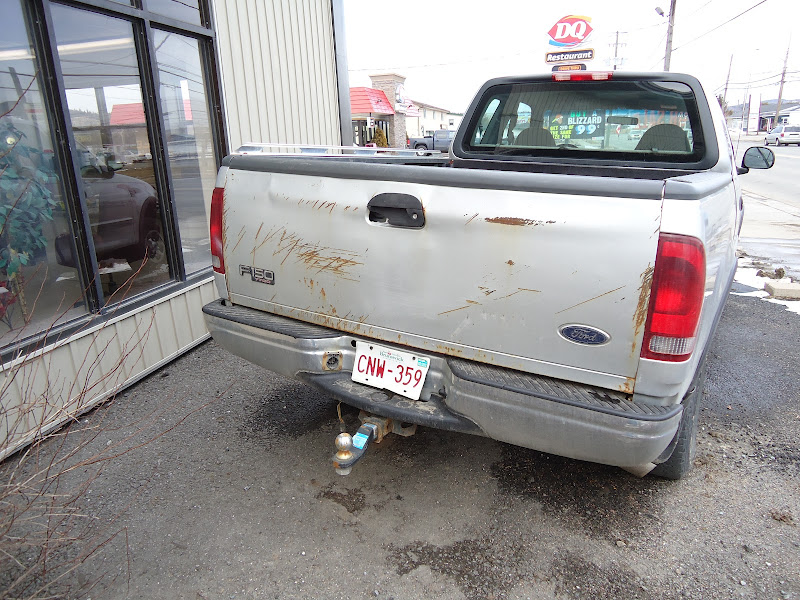

Should you end up replacing that plug I would be interested in the door for it. My 7-pin plug was relocated to the bumper (see here, a much better location IMO) but the door is long gone. Would really like some protection.
Old Apr 4, 2012 | 05:18 PM
Red02FX4's Avatar
Posts: 1,695
From: Bear, Delaware
In place of a tag light? I dunno about that one
