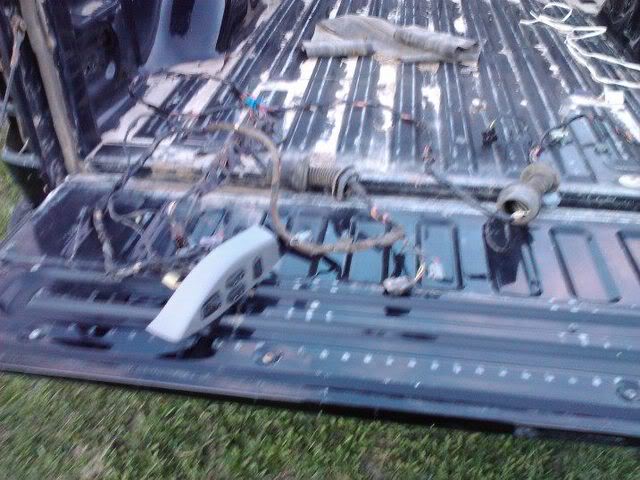

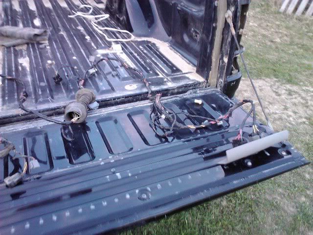

i pulled the whole harness from the driver door to the plug on the driver kick panel then up behind the dash to the other kick panel then to the left door and i pluged the harnes in to my truck to see if my truck would power the locks but nothing work but i did not have it fully intalled i just had the door lock actuaters on the seats do they ned to be grounded to the door? The door switches on do i have to have it all plugged in. I have power to the main switch Name:  564942_10151742878975241_900175240_24451035_2044211868_n.jpg

guys i need some help with this swap i dont think my truck has a G.E.M so the power mirrors and windows dont work but the door locks do when the harness is plugged in to my truck. is it possable to go around the G.E.M By just supplying switched 12v power to the window switch

Yes I was able to get all the power to work I used the factory door harness which runs behind the dash and plugs into the factory harness and the power locks work but had to add in 2 relays to power the 1 to power the windows and 1to power the mirrors but they all worked except the auto down. I sold the truck 5 years ago or i would show you how I did it I believe I just had to feed the main power to the driver door switch for the windows to work and feed power to the mirror switch. You should be able to find what wire is what on a wire diagram. Good luck I loved mine after I got it to work miss that old truck
