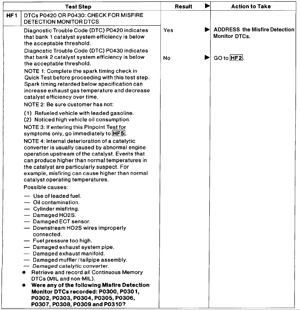

thats what i did i went to auto zone and got the code PO420 that all data told me to refer to a misfire but i already know which cylinder it is cause that number 2 cylinder wont come out it just spins if anyone has an idea on getting it out please liet me know

That code can mean you have a bad catalytic converter.. Or is that a typo and you really meant po402?

A misfire, especially if left unrepaired for too long, can cause a converter to fail.
