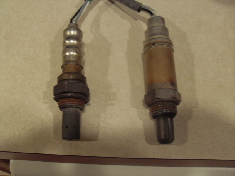

The one on the right happens to look like the one I put in the fronts of my 97 (bosch, napa counterman choice)
The one on the left looks like what I couldn't pull out from upstreams. I'll be watching to see if you find anything.
One on the left is a NGK or NTK rather, -same thing except, that isn't OEM.
Exhaust gases should spin around the ceramic inside. That's why the Bosch (on the right) has a louvered heat shield; -for that spinning effect.. The NTK's just get nailed and aren't as accurate when reporting to the PCM. The NTK can and usually will say "Ford" right on their sensor, as they claim to be OEM suppliers. This does not mean they are endorsed by Ford Motor Company. Put it this way,-Fram claims the same thing.
That's just my opinion from what I've read in the past about these sensors. Other than that, I have been running rear sensors in my truck for a couple years now, - I needed O2's w/long one piece harness for my LT's. I didn't want to splice or run extenders because the O2 wires themselves are sensitive. So I purchased rears because they offered the longer harness x 2". Great performance and 16 mpg city. I only get 16 mpg highway, but that's on cruise @ 78-79 mph.
Yea, I'm 100% sure.
Yea, I'm 100% sure.
Never doubted yah
, just hit with the whoa when I saw the difference in the 2.
It is an NTK, part number xc2f-9f472-a1a and does say ford. That came out of the truck with 10k on it, surprised it wouldn't be OEM. After looking at the ones on my truck, they are the same NTK up front and Bosch in the back. But I don't know if anyone's ever changed them. I'm going to order new ones for the rear, for up front, in case I happen to wake up one day to check the mail and find LT's sitting on my porch.

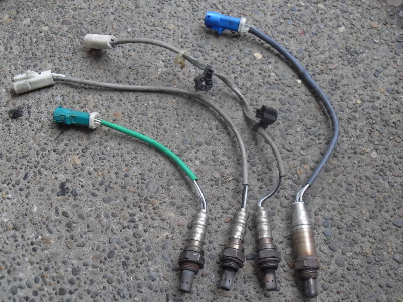

So these are the ones I just took out of the 99 with 125k on it, which I know nothing about the maintenance or whether these are original or have been changed. I can say that the one from the drivers side appears to have factory clips on it. They both seem to be oddly long wired for being fronts.
pictured left to right
upstream pulled from 00 with 10k miles
passenger upstream just pulled from 99
drivers upstream just pulled from 99
downstream from 00
Both 99 and 00 upstreams are NTK, whether they are original is unknown, but possible? Since the 00 only had 10k miles and the 99 has some factory clips.
Note the 3rd from left is the drivers upstream that the original CEL was indicating, it has a big white burnt spot on it, compared to the passenger side.
My parents have a 00 with low miles and original owners. I'm going to check what it has up front next time I get a chance.
I placed my order for new 02's but for now I used the downstreams (pictured right) from the 00 I had laying around until the new ones come it. I have a long road trip this weekend and didn't want to drive it on that bad drivers side 02.
