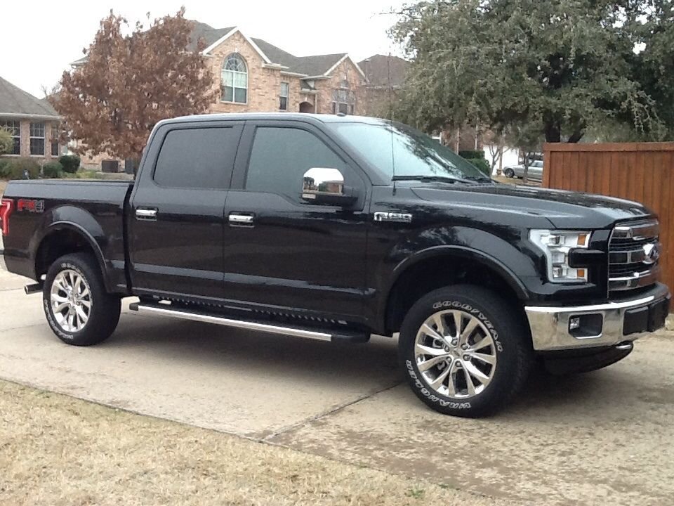

2" spacer kit from Autospring only netted me 1-3/4". I'm ok with the stance so I'll live with it. Just wanted to put it out there.
Kits states that the net lift will be 2"

Looks fine to me. Lift the front too high and then you'll need taller rear blocks to get the look you now have. I like a little rake so it won't go nose-high when you load anything substantial in the bed.

I could be wrong, but looking at the side profile I would say if you had any more lift in the front you'd have the dreaded 'cali lean' - you look pretty level as it sits now.
i have to agree. the front even looks a bit higher from the pics. i would have to say it looks dead level now

I'm totally satisfied with the stance now. It still has a little rake to it. I know measuring the wheel well height from floor is not the recommended way to tell levelness, but the rear stayed at 40-3/8" off the ground. The front went from 37-3/8" to 39-1/8" off the ground for a net 1-3/4" rise. So, while not the best way to determine "level" it is what the eye references when looking (at least my eye, anyway). I put a level in the bed on a flat street and it indeed still sits a tad lower in the front. Love it! I've gotten several compliments since having it done Saturday. Thanks guys.
