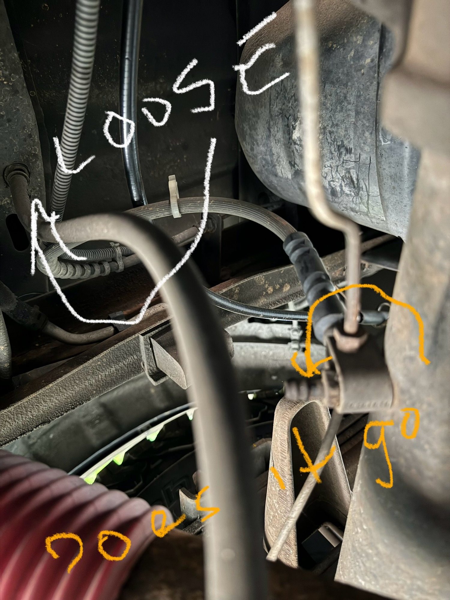

Anyone know what hose this is? It’s barely con
Old Aug 21, 2024 | 02:11 PM
It is barely connected above (and certainly not tight)
and not connected below (just above rear differential). Is it a brake vacuum line?

Could it be the differential vent?
I couldn’t find that as an option on Amazon.
The barb wasn’t attached to anything. And, the hose dangling from about was brittle at the end (and can’t possibly hold a vacuum).

The differential vent is not a vacuum hose, it attaches to the axle housing and the other end does just hang loose.. What are your truck details, please? It won't cause any issues if it's not connected.
