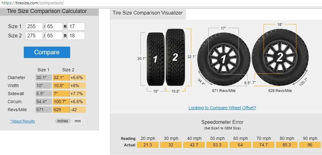

I currently have 255/r65-17's on my 2005 F150 XL RWD. Can I put 275/r65-18 on without any mods?
Old Sep 9, 2018 | 01:40 PM
Eh, it'll be close...
I'm running 265/65/R17 on my 2wd...
I would double check with a ruler and by using: https://tiresize.com/calculator/

Thanks for the info. I'll check it out.

You may need a leveling kit. I used a strut spacer with 33" tires.
