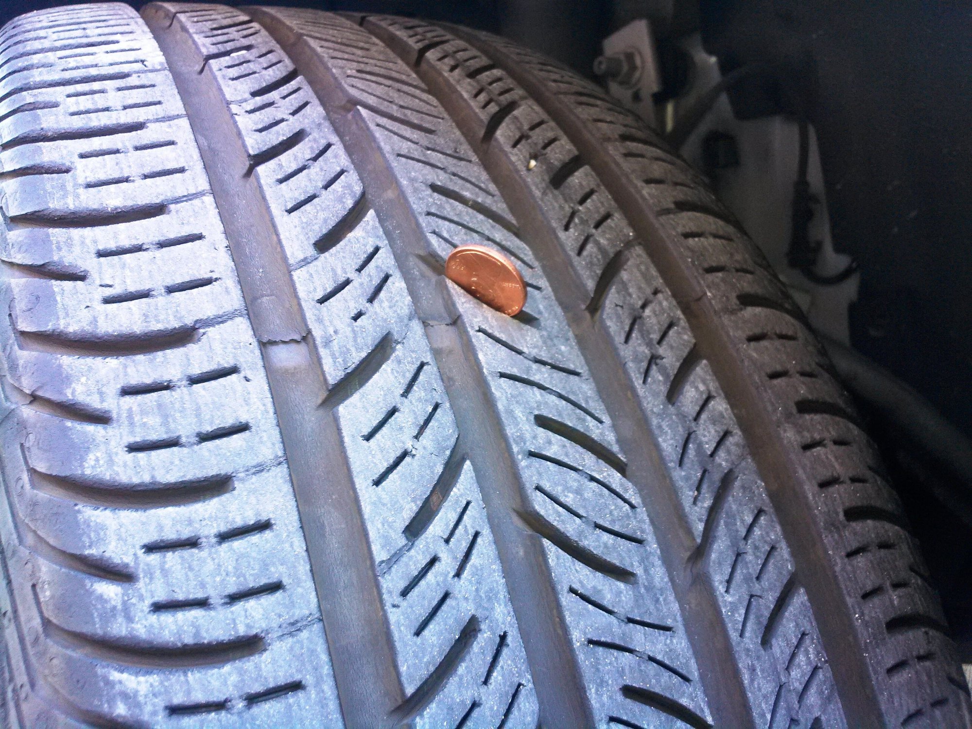

Funny that I was just explaining to someone how to use a penny as a tread depth gauge.
There are several popular ways to check your tire tread depth. One easy way is the penny test. Simply insert a penny into your tire's tread groove with Lincoln's head upside down and facing you. If you can see all of Lincoln's head, your treaddepth is less than 2/32 inch and it's time to replace your tires.
Check Tire Tread Depth | Goodyear Auto Service
https://www.goodyearautoservice.com/en-US/tire-basics/tread-depth
