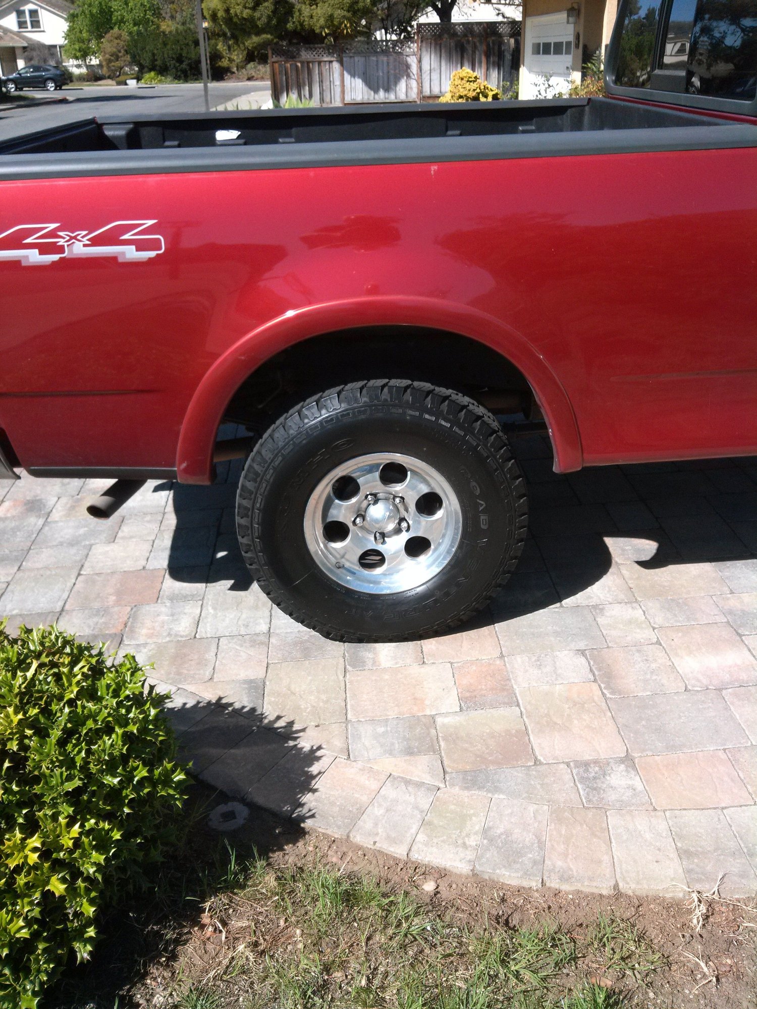

my rig with LT285/75R16's on it

That looks good I could of had some 35s today for free but they had hardly any tread and were severely weather cracked so I passed them up

Thanks!
These are 33's on 16' rims they were on the truck when I got it.

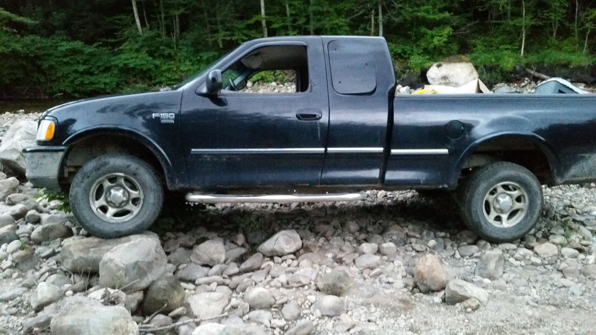

That was last year a day before i snapped both leaf packs playing in the woods i just barely got it fixed after 8 moths of sitting in the driveway
