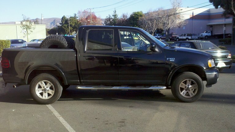

Figured i'd just start a fresh thread for all those interested in this set-up!
Since the guys here have always been great to help me out i'll gladly reply since i'm logged on it's been a while LOL!
Yes 16X10 4.5" BS is what you want and a bit of cranking up the torsion bars but i needed to trim a bit of the plastics and "clearance" the metal slightly with a hammer
I fit 305/70 16 Goodyear Duratracs on it and it works great i get lots of complements on the set-up but i now wish i went with the black centers instead of all polished (if anyone wants mine i'll sell them to get the blacks if they are still available)
Pics:
BEFORE:
AFTER:

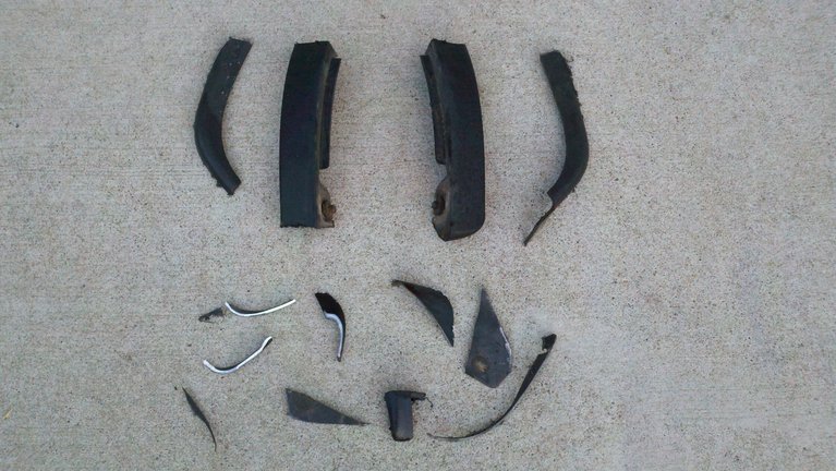

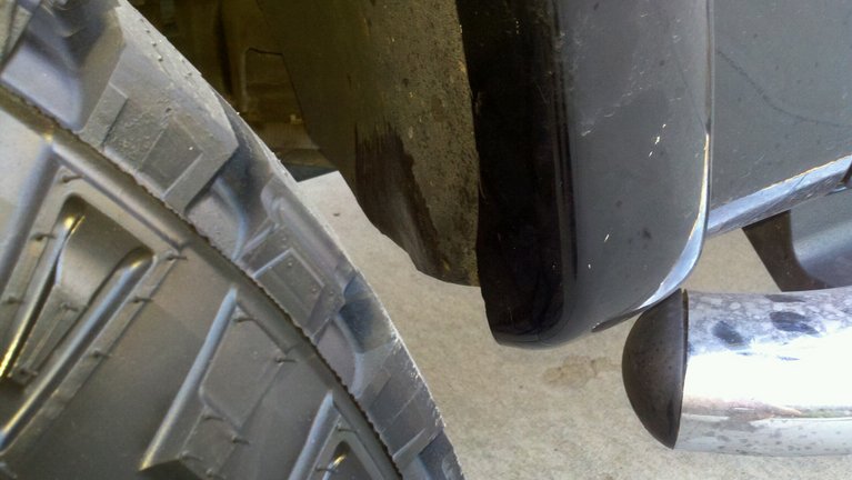

The amount removed from rear and front wheel well/front bumper plastics
