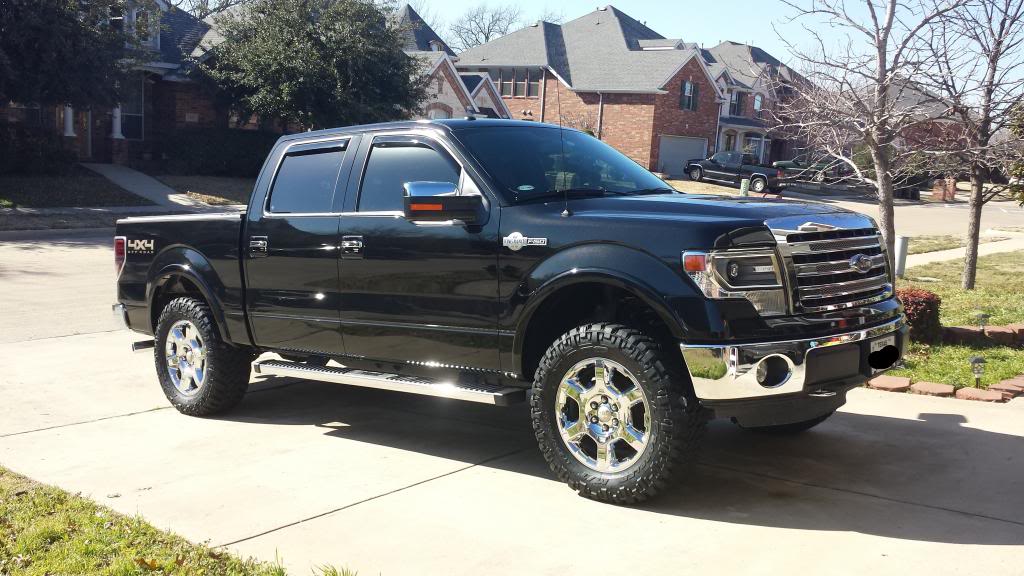

Billstein's with about 1.5" - 2" of lift will be fine with stock wheels. I'm running 295/60R20 Trail Grapplers on stock wheels with a 2" level. Only rubs at full lock on the UCA.
