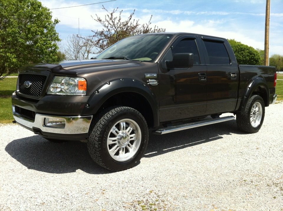

I have a 2005 F150 XLT that I bought last year... It's needing new tires .. The tires that are on it are Cooper Zeon 275/60r/20.
So.... I need to know what my options are on sizes... I want to go with a more aggressive tire.... The Zeons were awful in the snow and only so-so in the mud....
AND..... since I bought the truck as it is right now... I need to know if it is stock, or has a leveling kit on it..... I know that it sits quite a bit higher than my buddy's 2013 Sierra... And, I am used to old school trucks, as far as lift...... New front springs and blocks inna back... lol

looks like a 2 inch level to me.
your wheels dont look super aggressive, so you could most likely fit up to 35x12.5x20s on there. right now you have a 33 inch tall tire. biggest i would go is 295/60-20

Okay.... the brown truck is mine.... 2005 xlt that I bought last year, just as it is..... I need new tires and didn't know if it was stock or had a leveling kit... The tires on it are 275/60r/20..... and are Cooper Zeon.... they were awful last winter, and just so-so inna mud..... Just wanna know what I have, and if I can go up in tire size ??? Wider or taller... Thank you ..... MIKE.....
