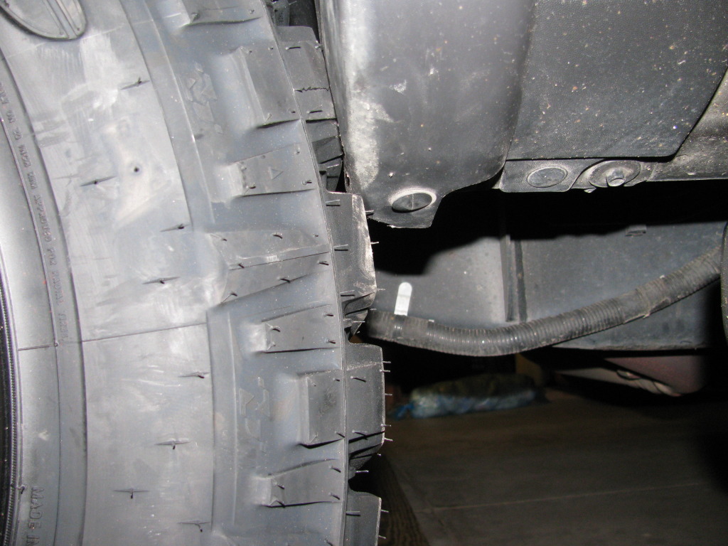

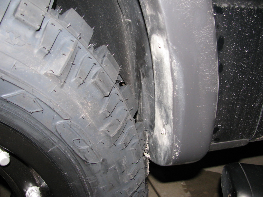

So, after hours of research on what wheel/tire combo to go with I ordered 20" XD Addicts (+18 offset) and 295/60/R20 Trail Grapplers. I know other guys are running this exact same combo with a little bit of trimming so I was expecting to have to trim a bit of plastic from the fender flare behind the front tire. Even after trimming the tires are rubbing a considerable amount. I don't think any amount of trimming is going to get them to work.
I am beginning to wonder if the offset is not what I ordered. Can anyone tell me how to verify that? I didn't see it stamped on the back of the wheel.
By the way, I have bilstein leveling shocks on front and rear. Front shocks are on highest setting.
Here is a pic (not a very good one) of the tire touching the fender well.

Wow, that is significant rubbing compared to mine. Do you have a pic of how far the wheels and tires stick out from the fenders? That would be an easy way to see if they sent you the -12 offset instead of the +18. Do you also have a pic with the whole truck in it? And you're sure whoever installed your Bilstein's put them on the highest setting?

Thanks for the response. I just received an email back from the vendor I purchased the wheels/tires from and they did indeed send me the wrong wheels. They are the -12 offset which would explain why they rub and stick out so far. I thought I was losing my mind there for a second.
They are going to send me the right wheels and pay to have the tires swapped locally.
