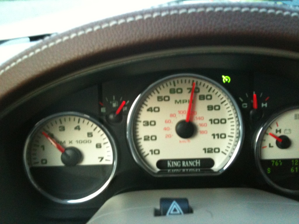

So if this chart is showing numbers for 65mph then my rpm's are not matching up for 3.73 gears and 35's... 70mph(74mph per gps). I should be in the 2328-2397 Range...
Old May 16, 2012 | 01:31 PM
str8t six's Avatar
Posts: 4,324
From: swamps of la
those charts dont take overdrive into account.
i think our over drive is like .70 or something. the chart is a 1:1 ratio.
