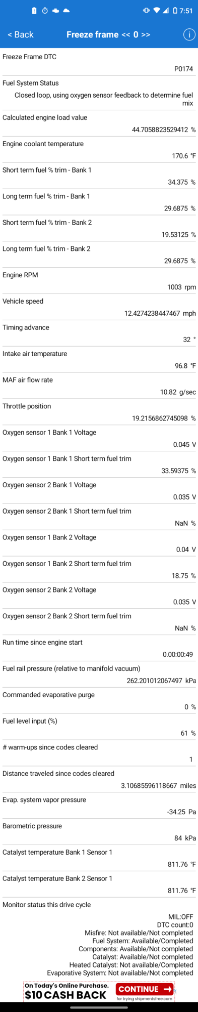

Here is a freeze frame after a KAM reset. LTFTs started at 0% and quickly maxed out at ~30%.

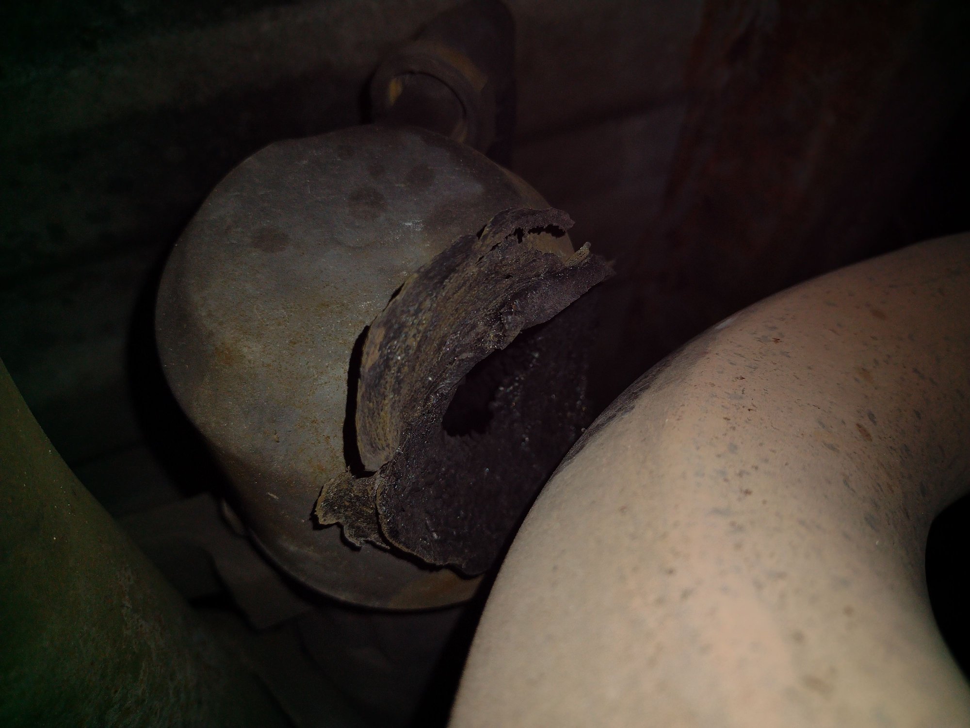

Apparently someone did a very poor job of replacing the exhaust at some point and the exhaust pipe was coming in contact with the evap canister and put a large hole in it. Could this be part of the problem? Is there a way I could plug off the vacuum line going back to it from the engine until I can get the exhaust repaired and new evap canister ordered?

Threads merged, sorry about that! The codes are p0171, p0174 and P2195, p2197 after the LTFTs get updated. I know there is no baro sensor but there is a PID for it and it shows 14.67psi in the manual for the reference value in all conditions. Mine is 11.6psi. also, here is what they fuel trims look like when I start it up, they march straight up to max

The screenshot is after it enters closed loop. Open loop it just says 0% STFT/LTFT. As soon as it enters closed loop (after a minute or so) trims immediately rise. It smells strongly of gas and is getting 9mpg or so it seems like there is a miscalculation somewhere and wants to dump all the fuel it can in to get to the correct af ratio, but can't get there.
