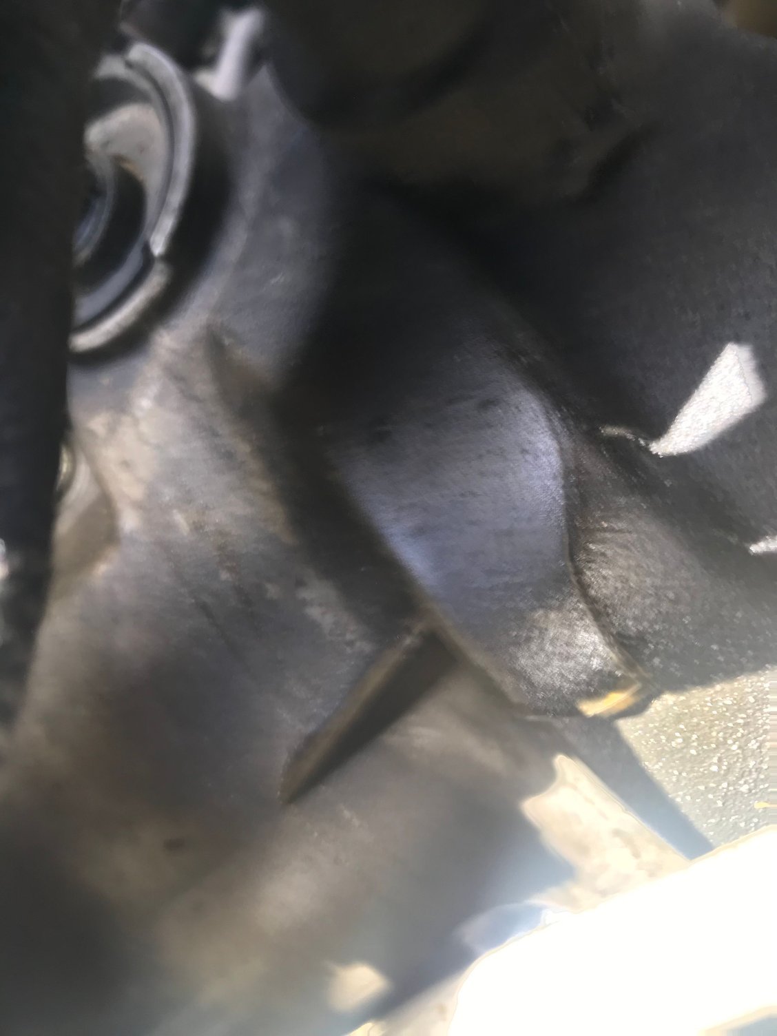

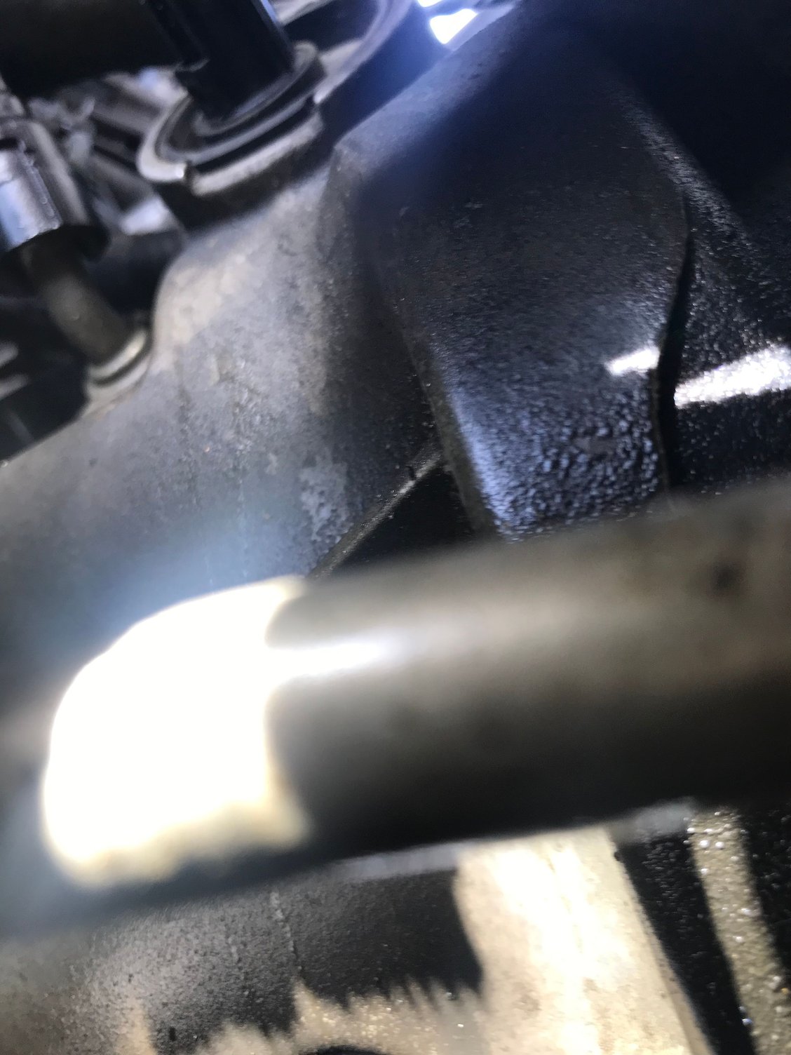

Drive slowly the rest of the way home. It has some hesitation going up hills but still feels ok. No bucking or stalling and only a slight rattle from pass side. Pull the battery out and find a crack in the pass side valve cover. Think that is the ‘crunch” I heard this morning. Absolutely no oil leaking before then. Scanner only has one code p0012.
I am waiting for it to cool off before trying to pull the valve cover off. I think by the location and engine code that something has gone terribly wrong on that pass side phaser. Just looking at what my next course of action should be.

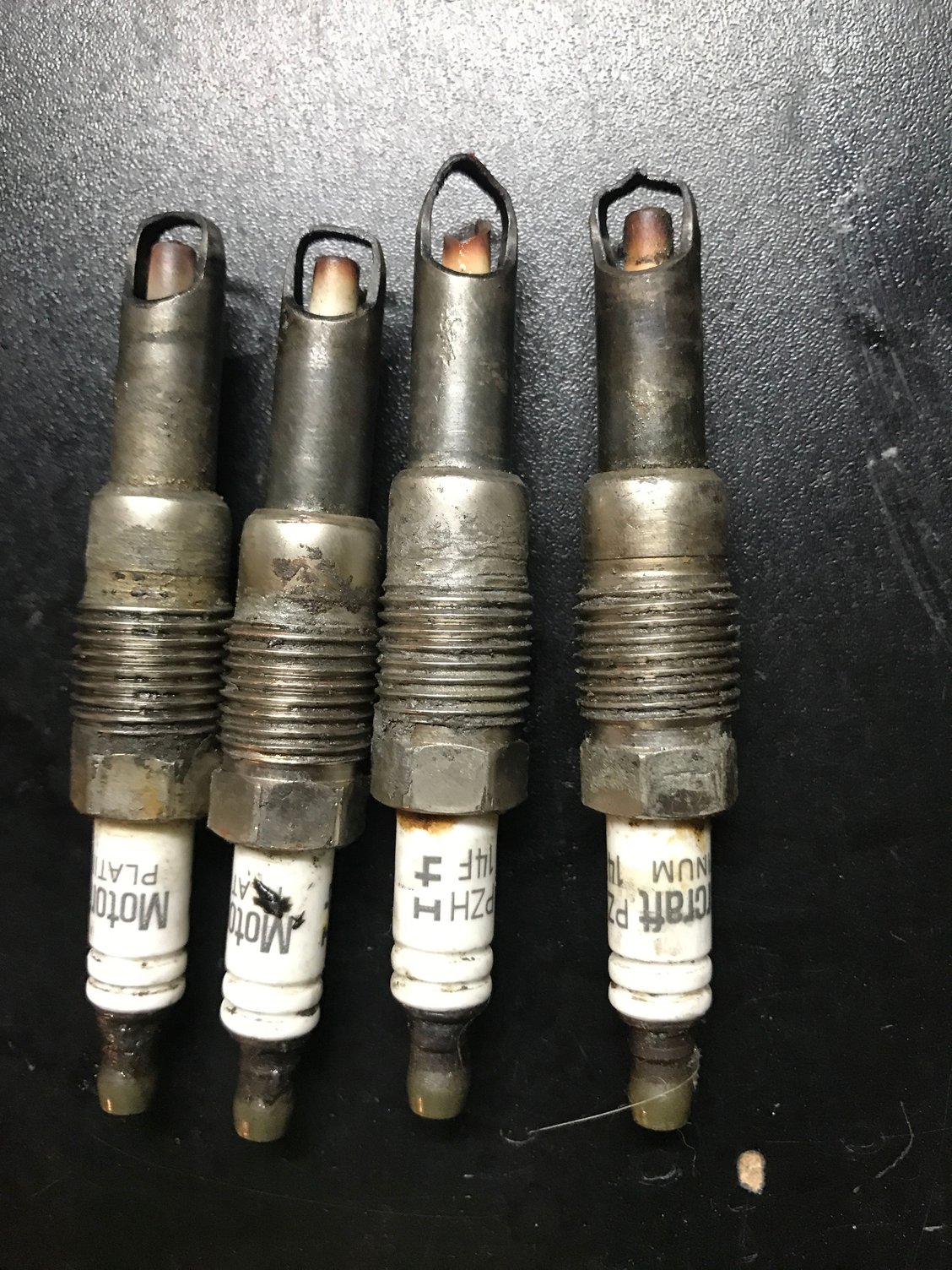

I’m thinking it’s a lot worse than I first thought. Didn’t get the valve cover off but the 1 yr old plugs look trashed.
Old Aug 28, 2021 | 09:37 PM
Posts: 43,542
Likes: 819
At least you got them out without breaking them.
