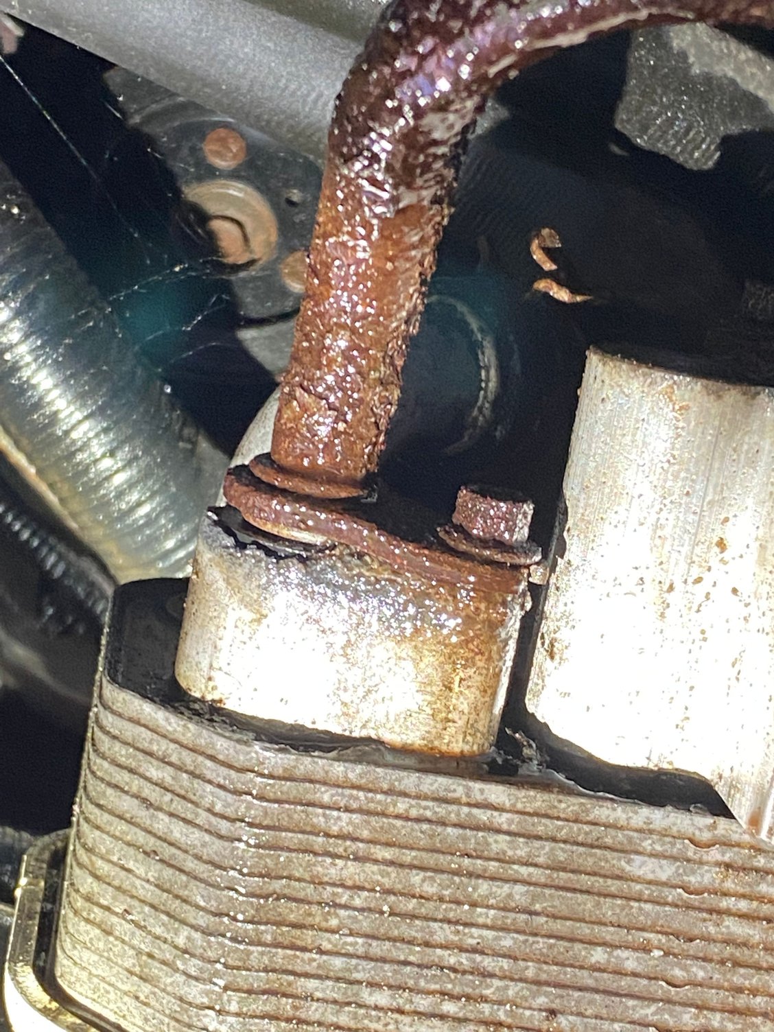

What is this silver box?
Noticed a small leak yesterday. Looked and saw this wet. Today there’s a good size puddle. Don’t want to drive it anymore till I fix it. Weeps pretty well when running. Slow drip when it’s off. 2016 5.0 Lariat Crewcab. Looked online, can’t find anything that looks like this. Is it transmission cooler or oil cooler? Looks like this pipe might have popped out just enough?

That is your transmission oil cooler.

That is your oil cooler.
why can I not find a single thing online about this box?

This is the oil cooler:
https://www.tascaparts.com/oem-parts...ler-bl3z6a642g

then that’s not what I have. The oil filter screws onto that. What is the thing in my photos then?
Aftermarket oil cooler??
Follow the lines?

Found it… transmission oil cooler.

https://www.tascaparts.com/v-2016-fo...ans-oil-cooler
Old Aug 17, 2021 | 08:17 PM
transmission "thermal unit"
It uses coolant to heat the trans fluid and help the transmission get up to temperature faster.
It can bypass and send fluid to the external cooler for extra cooling as needed
