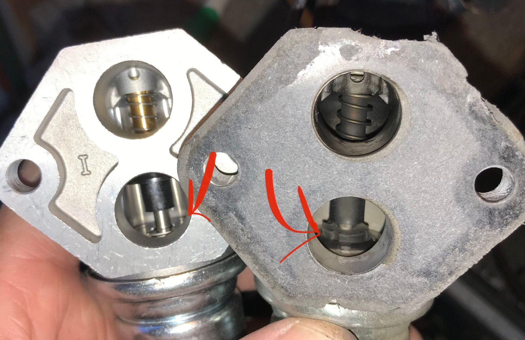

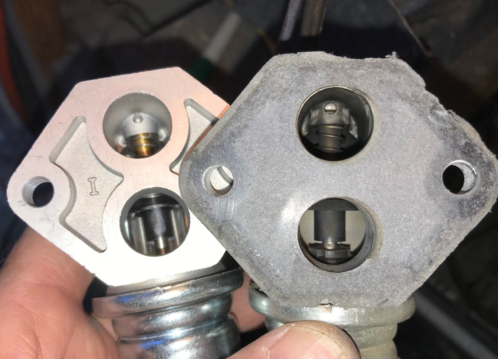

Haven’t had time to check the pressure on the fuel pump yet. But for $40 and since it’s 21 years old I went ahead and proactively swapped out the IAC. A little dirty but not anymore than I expected. I did note the difference between these two. It could be a simple design change or maybe someone can tell me if the dirty one is supposed to look like this.
Felt a little bit of vibration when test driving and turned out coil number six was going bad so swapped it while I was in there. Trucks running great all I can do now is wait for the heat of summer and see if it hesitates. It’s very hard to reproduce.
