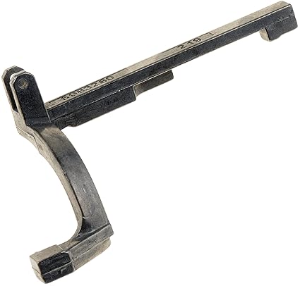

And just for fun, here's the part you want to pray is not broke. This is the ignition switch actuator. This requires the entire steering column to come apart.
