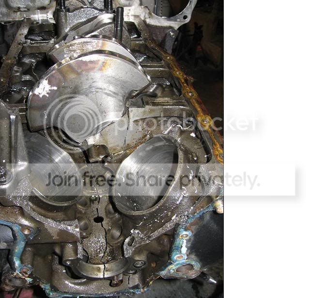

A 600HP 347 cu in

The 351W has a 4" diameter on the main bearings as I remember, much larger than other engines. this means the speed of the two surfaces moving against each other is too much for a high rpm engine. A 351 cleveland is a better hipo engine. But what you are talking about doing is VERY expensive and it won't be street legal if that matters. The shops would be doing something illegal federally if not in your state and they would open themselves up for huge penalties if they convert your truck to a non-legal vehicle.
