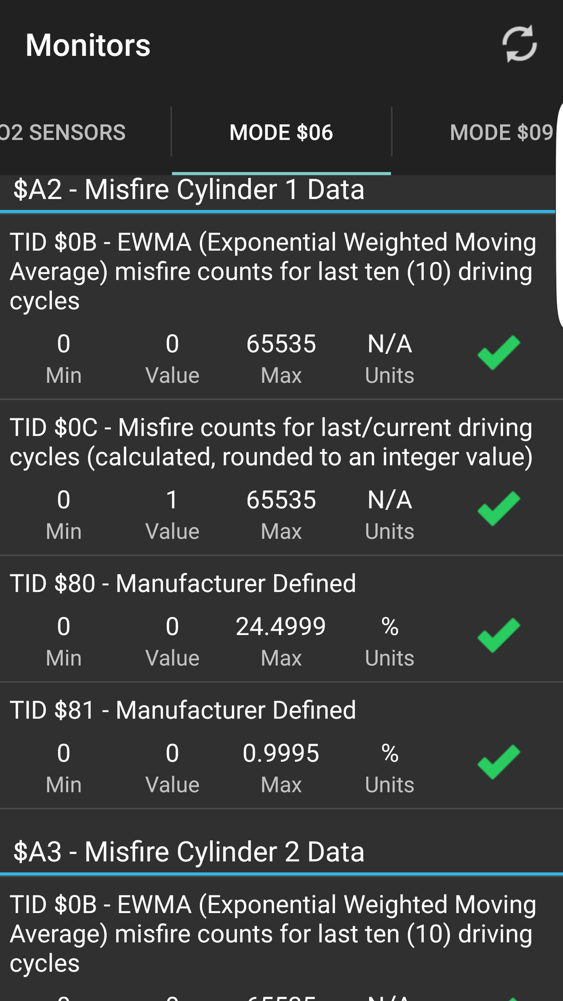

Hello fine folks.
Been on at this misfire for months now. Had it into the mechanic a few times and to be honest they didn't have a clue and kept chargingetting me.
Here it goes
06 f150 5.4 triton 125k. 7 Original spark plugs one new.
I misfire around 70-80kmph when the car is trying to gently come out of low revs cruise.
If I accelerate hard I can avoid that happening. No trouble at idle or anything like that.
I got one engine code once saying cylinder 1. So I swapped the crappy original spark plug (it broke of course) I also swapped the coils over from cylinder 2 to see if that changed anything. It did not.

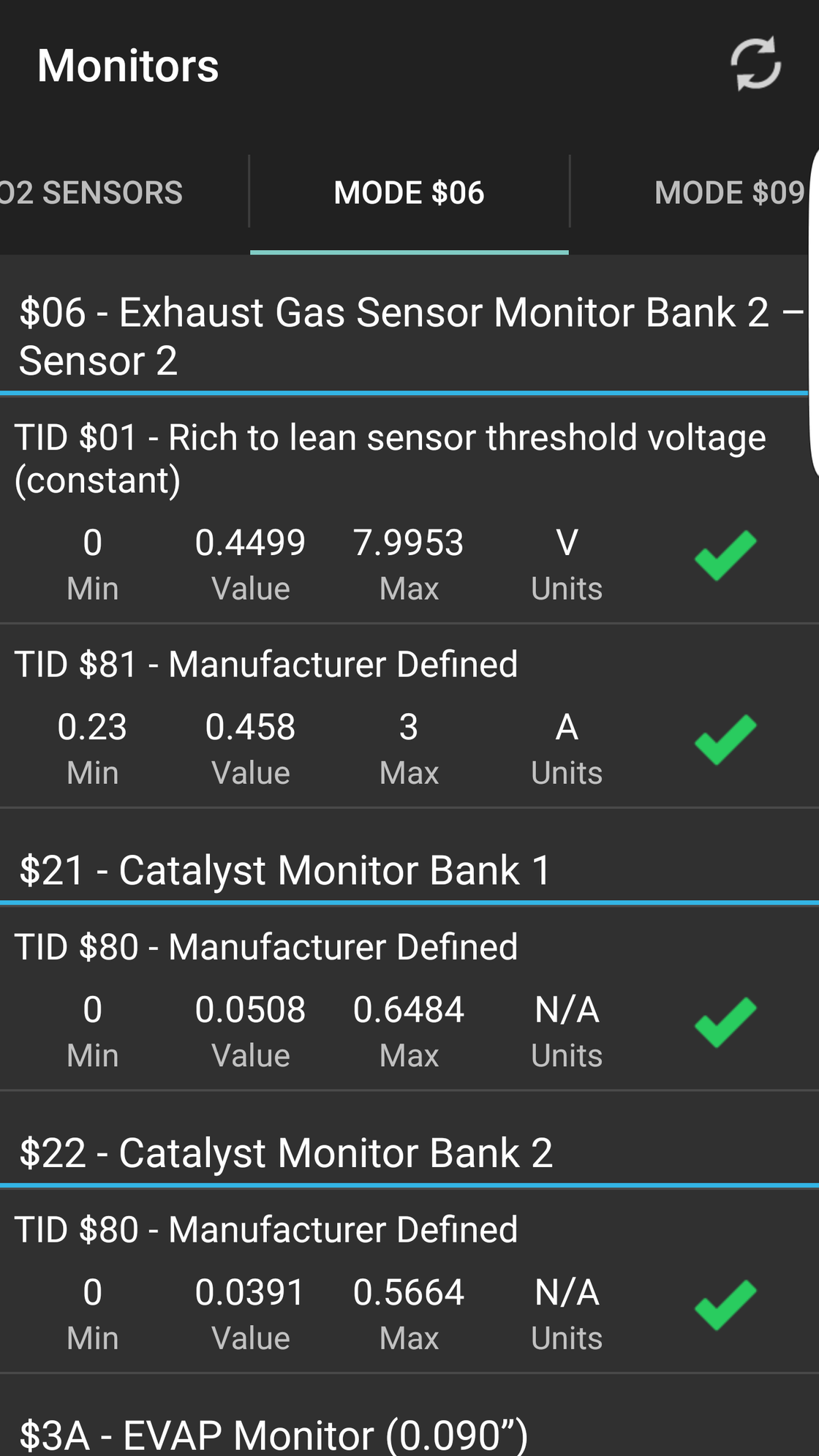

I was having trouble reading the $06 data as no values are showing. Then finally today I got misfires showing in multiple cylinders. The results are screen shotted below.
