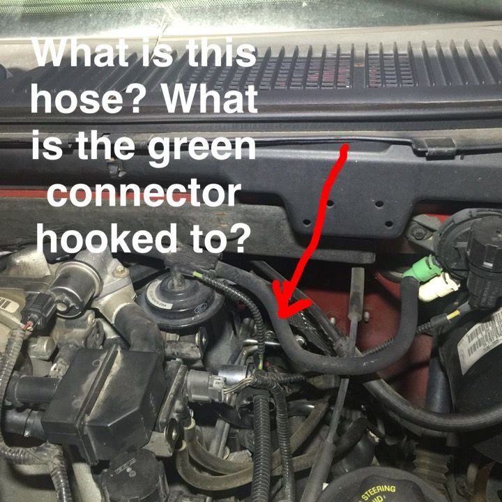

What is this hose??
What is the purpose of this hose and the thing the green connection is hooked to. The hose is horrible rotted shape.

Looks like a vacuum line. If that is leaking it could cause your problem.

The hose is the evap purge hose. The green thing is attached to the vapor canister purge valve, I think it's a check valve. The white thing under it is the solenoid that operates the purge valve. If the hose is leaking, that will definitely be a vacuum leak and will trip lean codes. The hose can be replaced with any fuel-duty hose.

Ok I changed the hose in picture and Fuel filter, and clean MAF sensor, not much change on high RPM 3800-5000
