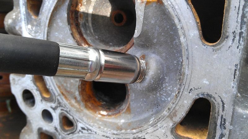

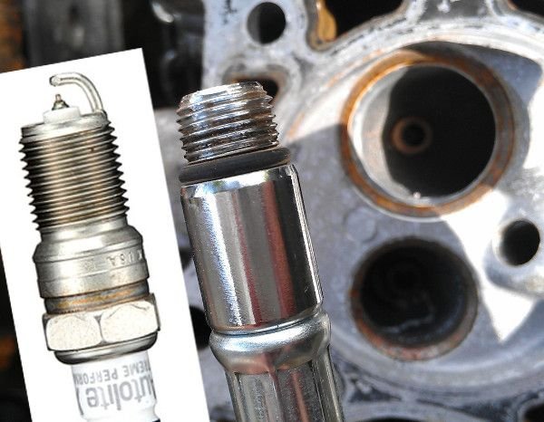

I picked up one of these cheapo $45 cylinder leak-down testers from Harbor Freight last year. I'm now in need of trying to use it to diagnose my leakage problem. However, despite having a 14mm x 1.25 threaded adapter within the kit, I am completely unable to get the damn thing to thread into the spark plug hole from the top. I've confirmed that it IS the proper threading, since I can thread it on an old head from the cylinder side. My guess is that it is either too short on threading and/or too fat above the threading.
Does anybody have a lead on a M14x1.25 spark plug adapter that they know to work on these '98 4.6L v8(s)?

thread adapter next to spark plug
threads from the cylinder side, but not the top
cheapo HF leak-down tester

just to circle back on this, if anyone else has the same issue, I bought a "Star Products (STA70328) M14 HOSE ASSEMBLY - LONG THREAD XXX" and it worked perfectly ... just make sure you take the shrader valve out first
