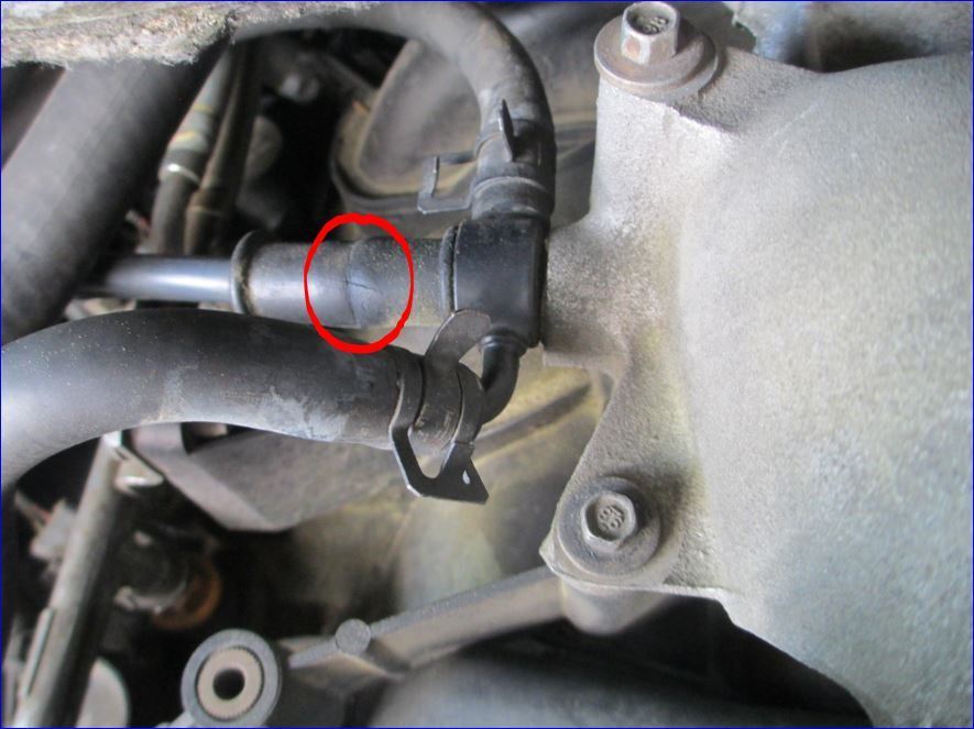

Problems seems to be fixed. Appears that I had a vacuum leak and a bad COP.
After checking hoses again...this time in the daylight I found a crack in the rubber fitting that connects the PCV line to the throttle body PCV tree(???). I have the coolant heated PCV setup.
After wiggling it a bit, it looked like this.
I replaced just the cracked rubber piece with a piece of fuel line hose. No visible difference in performance. Truck still shuddered with acceleration. I replaced the #8 COP and boot based on the P0308 code. Shudder gone and all codes still gone after ~120 miles.
Question: Do you think the vacuum leak and the bad COP were a coincidence or could have the vacuum leak led to the bad COP. Note that the SES light for the P0171/P0174 was out for about 400 miles after cleaning MAFS before the P0308 and shudder started.
