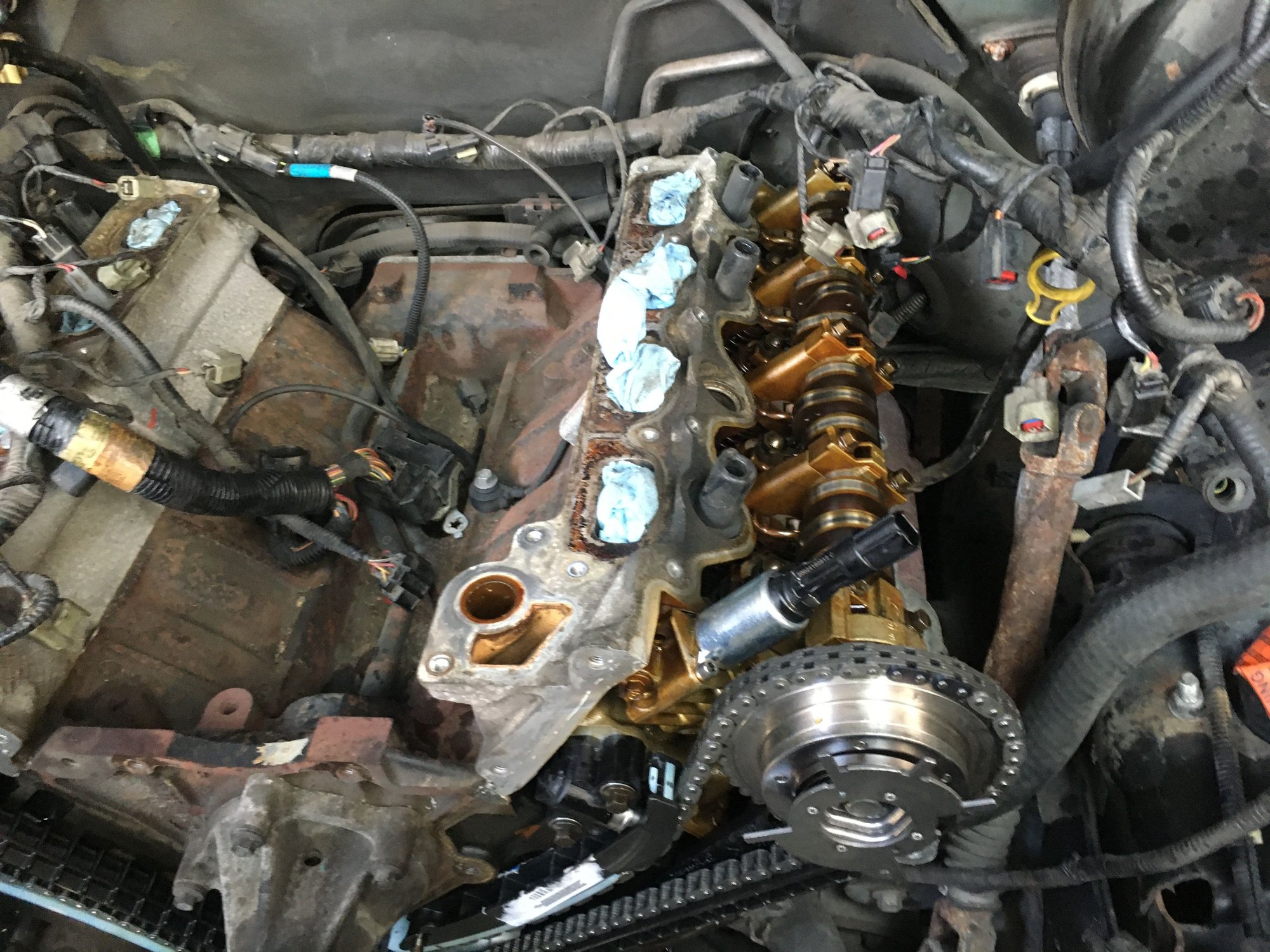

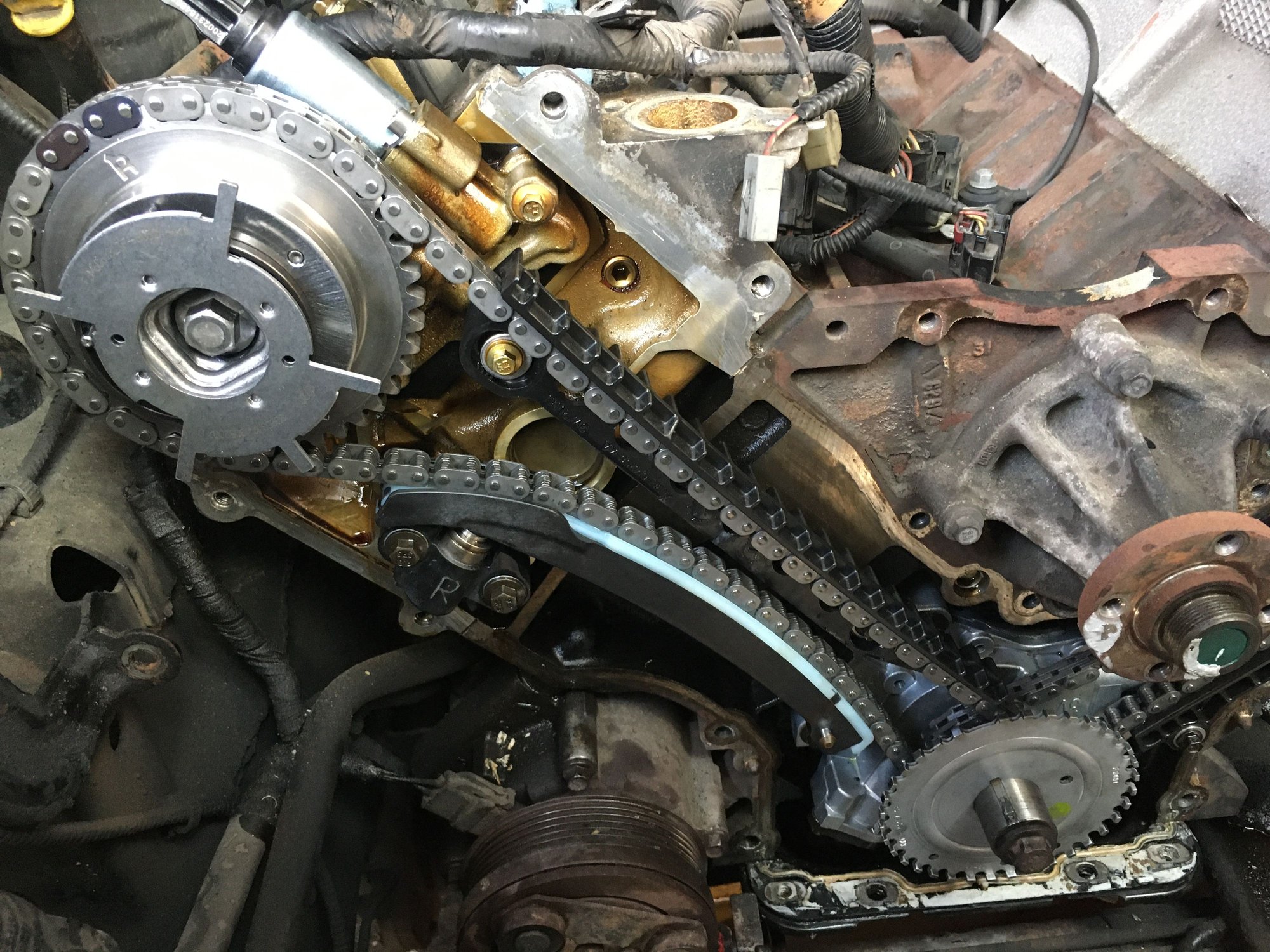

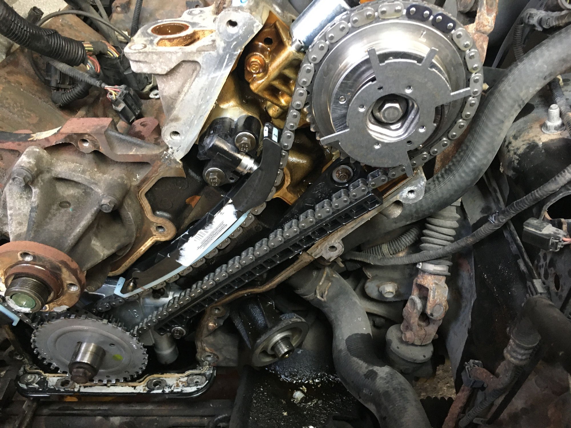

Old Jul 20, 2020 | 02:21 AM
Luiz Ferreira's Avatar
Joined: Jul 2020
Posts: 3
Originally Posted by glc
Reading your post again, if you are having the EXACT SAME issue as the previous posters, you may have mistimed the engine when you did the timing chain job, and/or the phasers aren't working properly. Have you scanned the OBD2 for codes?
yes, when it first happened I had a P2006 code, but it could have been there for a while.. I was suffering a mild case of rough idle before I did the timing job as well.
I had driven for a week and took to my mechanic, and there are no codes since I reset it.
The timing was done correctly, but I wonder if the cam phaser already went bad again, or if I didn’t torque the cam phaser bolt enough, but I did the 30lb+ quarter turn-thing.
I do have a ticking noise back, but it doesn’t go away when i high rpm, which makes me believe it could be a lifter (did not replace the lifters and roller follower🤦‍♂️, but going back in there on the 30 to take care of that+camshaft&#128077.
if I step hard on the gas pedal, the symptoms will last from lower rpm all the way to high… If I step lightly, the loss of power will start around 14000rpm, and go away after around 2200 RPMs. I wonder if it’s because the torque curve comes down, which generate less gases and allow the semi plugged catalyzer us to let the gases scape??
I am installing for new Walker catalytic converters, JBS 1676 headers and magnaflow muffler this weekend(I was doing the other two already, and got a deal on the labor.. figured it doesn’t hurt to replace them regardless).
I have this truck since brand new (F150-04), and finally decided to build an Overland out of it. It only has 150,000 miles and it was very clean when I opened it up. I never had this loss of power, I don’t want to lose the engine since I already put fox shocks 2.5 extra resi and Dsc, 5-star tuner, 4.30 gear, e-locker and eaton lsd..
thank you so much for your help!
