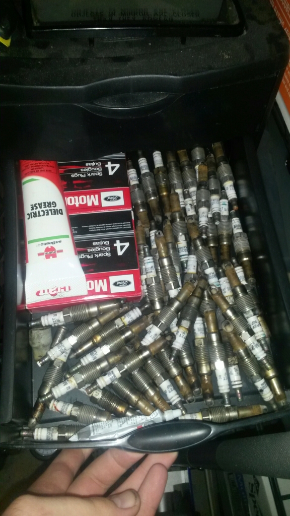

full WOT on throttle in Reverse until the plug is all the way out
here's my draw full of my removed plugs, including my special plugs that came out. The boxed up plugs are for a 2v 4.6 so disregard the part number

I'm surprised your customers let you keep the plugs. I'd want to keep mine like a trophy
