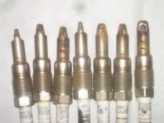

Photo of Plugs
I finally took a photo of the plugs that I removed a few weeks ago from my '07 5.4 3v with 55k miles on it at the time. You can see how clean they are probably because of the fuel additive i ran in it the weekend before I removed the plugs. But I still had some difficulty removing them because they didnt have any lubrication on them.

Thanks for the success story with great pics I might add A Dub. I'll be tackling the same thing tomorrow with the same exact Brisk plugs.
