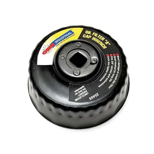

Originally Posted by vogel
i really get a kick out of all the oil filter comments. at the dealership we call them virgins they are a bitch and a half to get off but if you use a claw wrench or can figure out how to get a band wrench on it it just takes a little elbow grease to get off.
This little toy works wonders. Slip it on the end of the filter, then get a big 3/8 breaker bar.
OEM 25400 Oil Filter A Cap Wrench 74/76mm
From the Manufacturer
This 'A' Cap Wrench has a 74-76mm diameter and 15 flutes. These specially designed end cap wrenches remove hard to reach multi flute oil filters. Use with 3/8-inch drive tools. This wrench will not damage or crush filter. Heat-treated for strength and durability.
