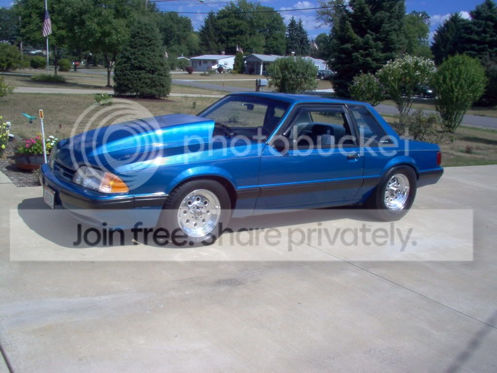

I say go with the 460 this is what i put a 460 in
and it still has 4 cylinder front springs.It was also a pretty simple swap,Later Mark.
