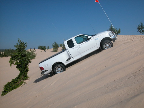

With less than 4 quarts of oil in my engine, (unbeknown to me) I was doing this at the dunes all day:
Never had a loss of oil pressure on those hills. I'm quite sure that extra 1/2 quart to take it to the MAX line isn't necessary to maintain oil pressure.
