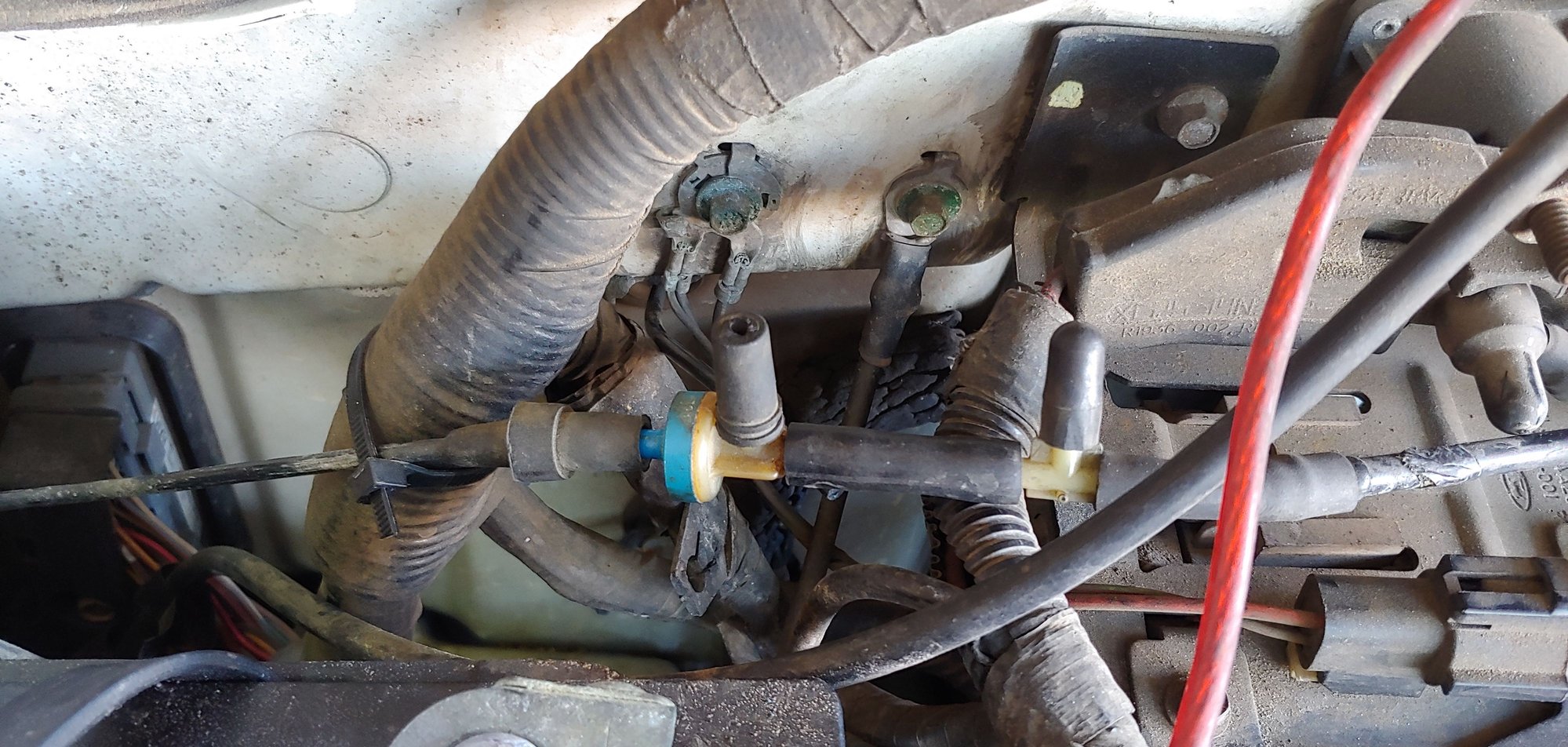

Dunno what this is.
I don't know what to search for, because I don't know what it is.
I need help identifying a part. It looks like some sort of check valve for the vacuum system? It's a small plastic 3 way with a very small hose going into the firewall (passenger side) by the battery. It's blue and white.
The part stumped AutoZone, O'reilly's, and Advanced Auto.
Old Jan 17, 2021 | 03:20 PM
Those parts boys/girls behind the counter are 9 times out of 10 useless...
It's a Motorcraft YG429 Vacuum Control Valve... in short, it's for the IWE system for your 4x4.

I believe even though he has a 2004, it's a Heritage, which doesn't have IWE, and I don't think he has 4wd. I believe it is a vacuum check valve for the HVAC system. The YG429 does not fit a 2004 Heritage. I think this may be what you need:

Ahh, I didn't read enough into it. glc is right. Either way, good posts for someone to search on if they need to know the differences.
https://shop.advanceautoparts.com/fi...um-check-valve
it is indeed a check valve
for the HVAC system, and the vacuum canister behind the battery box

That was completely my fault. I could have put that VALUABLE info in my original post.
2004 F150 Heritage4.2L V6
152,005 miles
Thanks again

I believe it is exactly like what you think it is. It’s a check valve for the vacuum system that operates your environmental ductwork in the cab. Look up “Motorcraft YF29” and see if that looks right to you.
