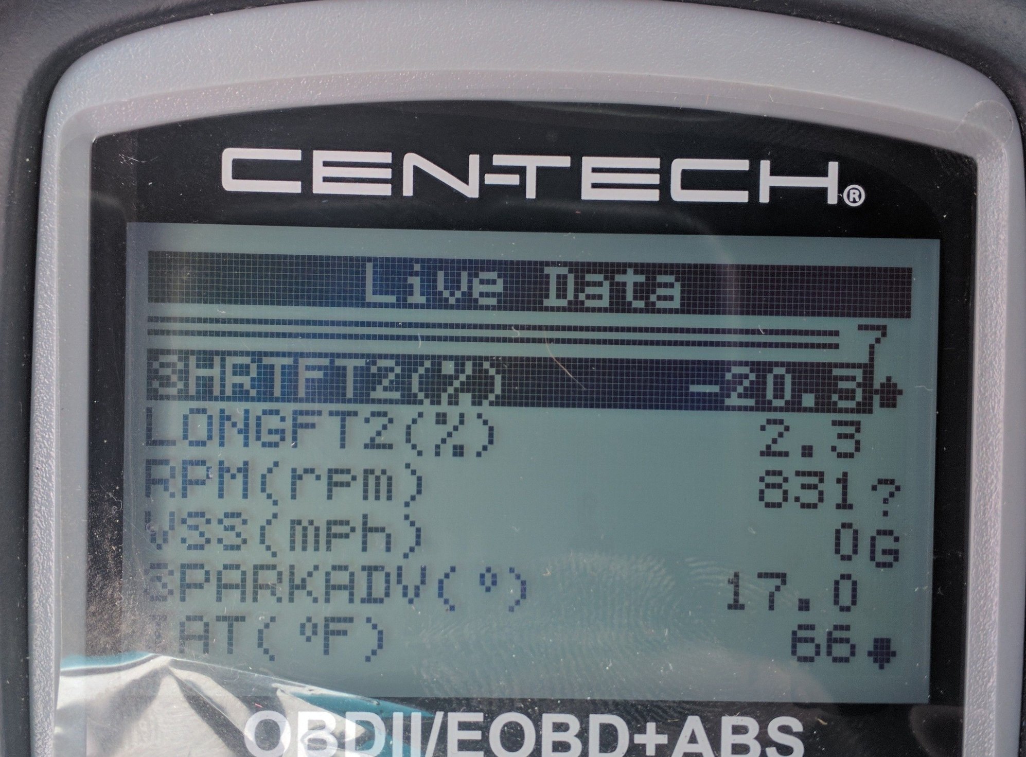

here are a few screenshots of live data.... not quite sure how to interpret. there were no codes stores or otherwise.

You do need to fix the vacuum leak, look behind the battery at the small vacuum hardlines and the accumulator.

Well, it may have gotten worse to the point that it's upsetting the fuel/air balance? I don't know.
It's quite possible your EGR valve is sticking partially open, that will kill the idle.
