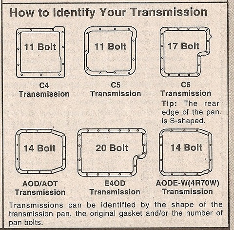

You'll need to know which transmission you have. You can have the E4OD or the 4R70. They're not close to the same. You can tell by looking at the bottom bolt pattern on the pan. The E4OD, at least mine, does not have a filter as such. It has a screen that acts like a filter. The price quoted doesn't seem right. Are you confident in the transmission shop that gave you the price?

With a 5.8 it's going to be a E4OD. The 4R70W was only used with a 5.0.

Yes I checked the pan it's 20 bolts so I know it's that one
