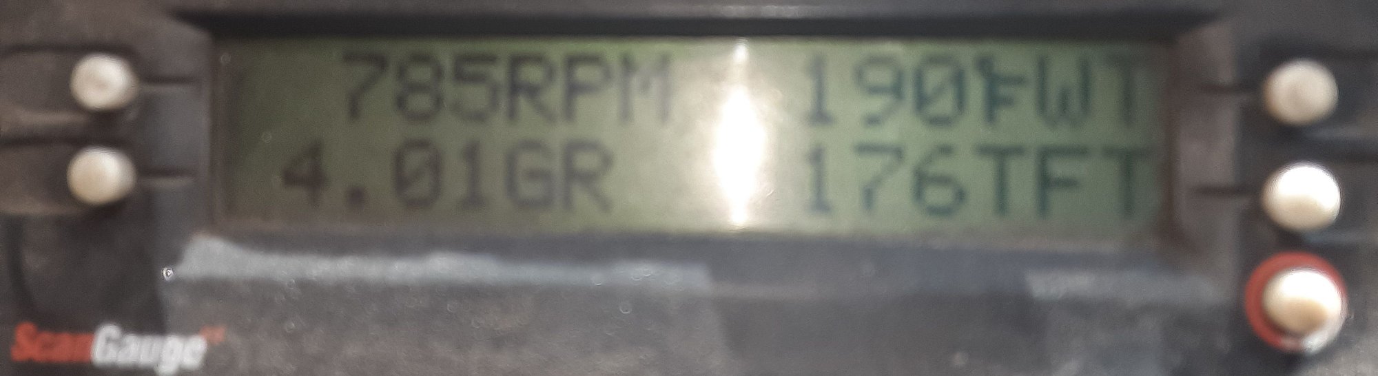

Not that it is relevant to you, here is what my truck showed after 30 minutes, driving 8.5 miles, in stop and go traffic.

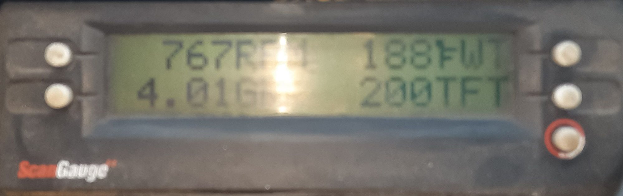

And after driving all day, all in stop and go city traffic; it means that I have a gauge device which gives raw data and the data is not all that useful. The only thing that I can extrapolate is that the truck is not overheating. Maybe I didn't need a gauge to tell me that.
