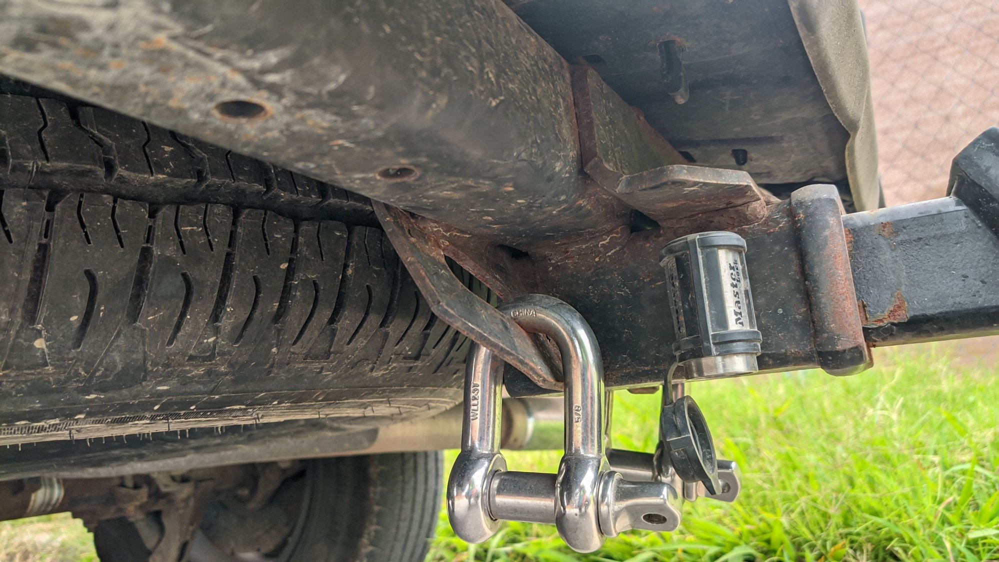

The sticker is completely removed from the hitch. Can anyone identify this one so I know what the max is with weight distribution hitch. Bought the truck used so I don't have the window sticker to know what tow package I have. 2015 145-in wheelbase 3.5 EcoBoost 4x4 does have 7pin / 4pin with 7000# gvwr and HD frame rating

You should be good to 10k with a WDH. However, that will probably put you over max payload for the truck.

Thanks for the reply but I'm more concerned with what the max hitch weight with WDH it is rated for and if it's even a class iv hitch.

Even a Class 3 is good for 10k with WDH. Tongue weight limit with WDH is 1k.

Coulda swore I saw the class iv rated at 1100 and 1200 depending on tow package when using WDH
