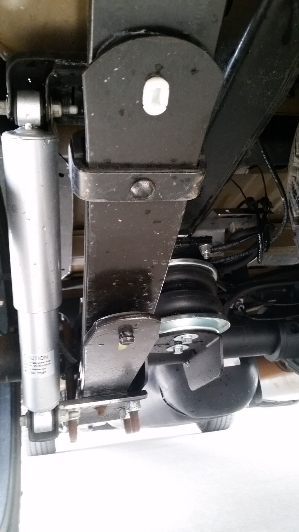

My 3rd and final attempt adding 5k bags . Tried the Slam Air kit first but wanted a higher rated bag so went with Air-Lift 5k bags over the axil but had a firm ride. .. Recently had my fabricator make custom mounts and relocate bags behind axil. Was a challenge because truck is lowered 6" in rear but couldn't be happier with results ! Much better ride and will easily support the weight of my 30' foot boat
