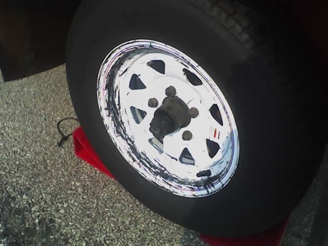

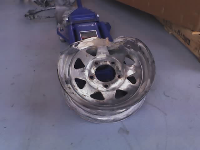

There's usually a fudge factor in there, but if you overload a single axle trailer, you have a greater chance of tire failure and overheating wheel bearings. This is why I said what I did about keeping an eye on the tires and hubs and keeping the speed down. Been there done that - I used a single axle 5x8 to move last summer and made multiple round trips - 600 miles each way - and I blew a tire on one trip and spun a bearing on another. I never weighed, but I'm betting I was over spec and it was an old trailer that had not been properly maintained. It was a dryrotted CAR tire that failed and I have no idea when the last time the bearings had been serviced was. It was also during a heat wave and I was driving faster than I should have. I now know better and am happy to share all that with you. The TRUCK had no issues whatsoever, just the trailer.

If the trailer is brand new, you should not have any issues with the tires or the wheel bearings, even if you are slightly overloaded. If you are going to keep the trailer, I'd recommend an annual service, including repacking the bearings. Have a safe trip, and please let us know how it went!
