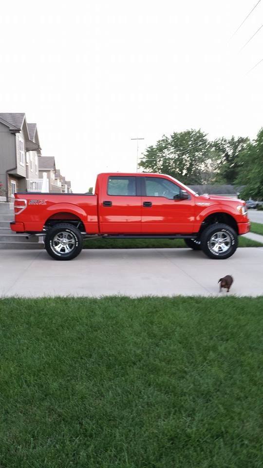

I went with the 6" BDS kit and I love it. The warranty thing is what sold me on it.
