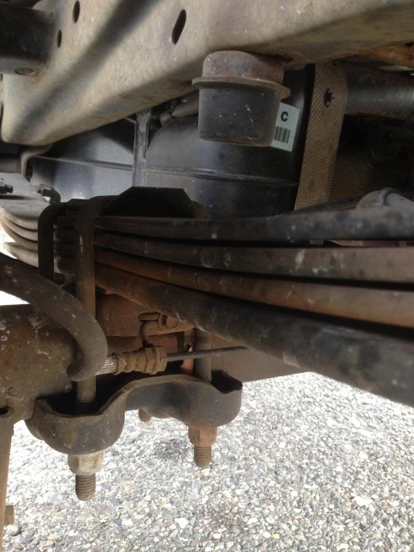

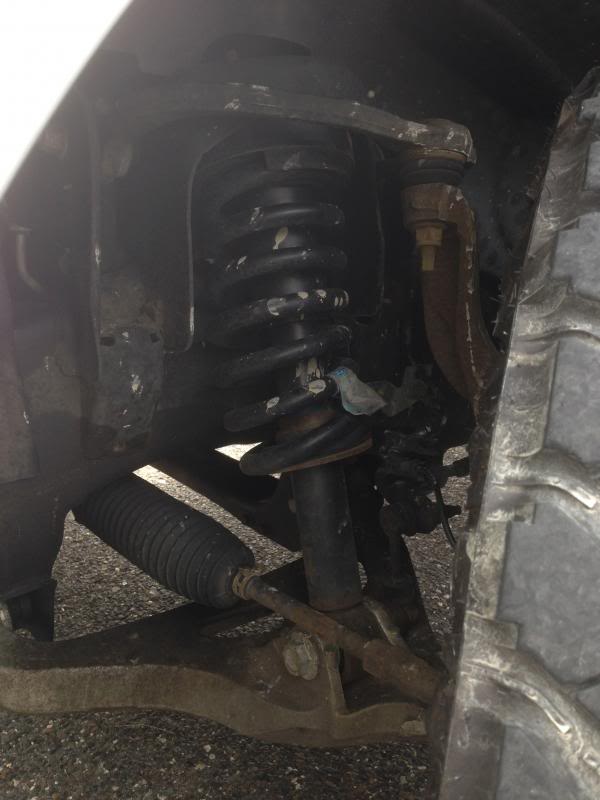

My 2wd f150 was extremely raked when I purchased it. I have since purchased 33/10.5/18 nitro trail grappler on 18 moto metal rims. I installed a 2 inch leveling kit but it still looks raked. I was thinking of bumping up to a 3" level but I have read nothing but bad news. Is this normal? what else can i do?

Have you checked to see if someone installed a bigger block or add a leaf in the rear? Because that would explain the extra rake over factory.
And yes a 3" leveling kit wouldn't be good for the front end, it'd give you some nasty angles.
But another thing, judging by how stuffed those 33's are in the wheel wells, I have a feeling that if you lower that back to level it, it might cause some rubbing up on the front when turning.
But take some pictures of the front and rear suspension and that would be able to help us more.

I feel like there's a drop on that truck . . . Your truck looks like it was lowered 2" before, and looks "normal" with the level
I'm almost certain it's been lowered. Definitely take some pics of the entire front suspension and the lead spring hangers in the back. My albums have a pic of my 2wd 06 in my driveway with 33" tires at stock height, which looks like yours now. The rest of the pics are with 33" tires and a 2" level.

I was going to say the same thing. That looks low even for a stock 2wd.
Now that I'm off my phone and on my laptop, that definitely has at least a 2" drop up front.

<a href="http://s40.photobucket.com/user/fox125racr/media/IMG_4492.jpg.html" target="_blank"><img src="http://i40.photobucket.com/albums/e223/fox125racr/IMG_4492.jpg" border="0" alt=" photo IMG_4492.jpg"/></a>
Rear
<a href="http://s40.photobucket.com/user/fox125racr/media/IMG_4491.jpg.html" target="_blank"><img src="http://i40.photobucket.com/albums/e223/fox125racr/IMG_4491.jpg" border="0" alt=" photo IMG_4491.jpg"/></a>
Front AFTER leveling kit!

Rear

this is the rear high
this is the front after 2 inch leveling kit with 33" tires
