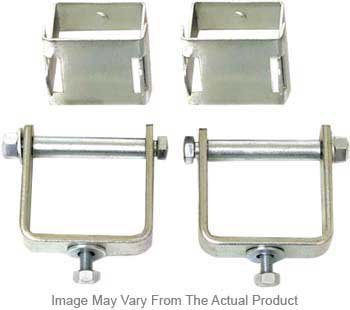

I used a hammer to get it close, then a large c-clamp to slowly bring it back to original.
Old Jan 29, 2013 | 10:24 PM
06yz250f's Avatar
Posts: 6,657
They sell aftermarket clamps which would be easier if you aren't too ****. Never used this style personally.
