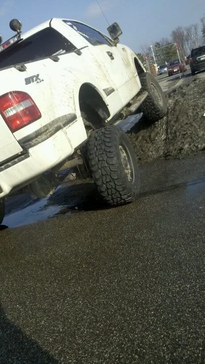

I have been plagued with random noises coming from the rear and had no idea what was making them. First the leaf spring clips came loose so I took it back to the shop that installed and they replaced them. They came loose again and rattled like crazy. I figured it would take care of it myself and got a set of bolt on spring clamps. The noise changed from a rattle to I guess you could describe it as metal crickets. It only makes noise on smooth road . I took the bolt clamps off and the noise isnt as bad but it's still there. I rotated my tires and just noticed this...
Could this possibly be the mystery noise that Im hearing(and the reason my clips keep coming loose)? It's only coming from the side that's out of order.
Should I even trust the shop to touch my truck again or DIY?
Heres the pic
Good side (just a arbitrary number for spring length)
4
3
2
1
Bad side
4
2
3
1
And a little flexing for your enjoyment
and yes I tried to paint my new dynomax bullet...the paint said good to 1200 degrees ...guess not

I think the noise is being caused by the springs out of order where you can see in the pic of the bad side the shorter spring (2) is stuck inbetween (3) and (4). And most likely causing a rubbing without any of the "padding" I guess would be a good term for it inbetween it and where it hits up against (4).
Also is the picture of the bad side at a weird angle? Because it looks kinda like your spring is going into a little bit of negative arch.
