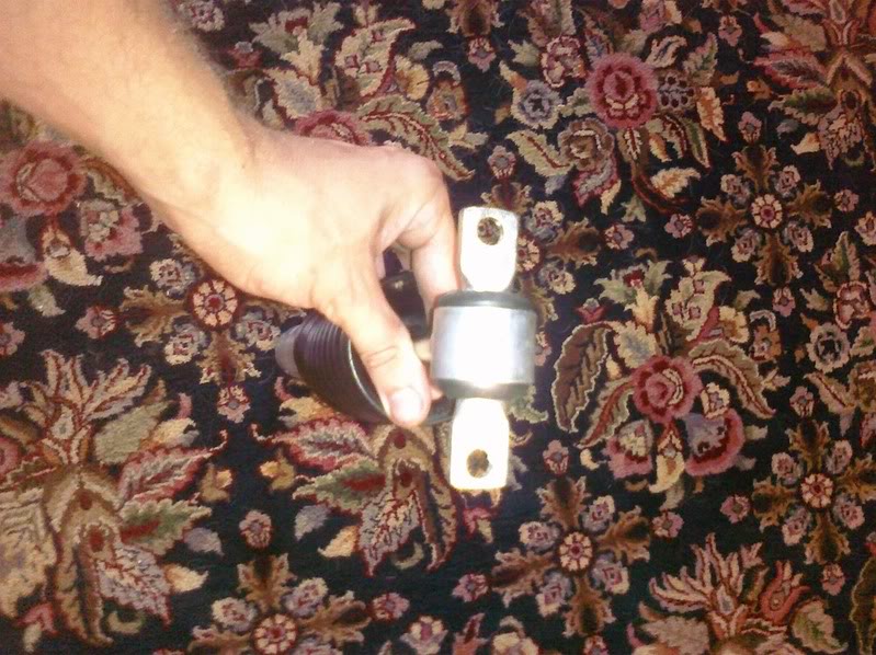

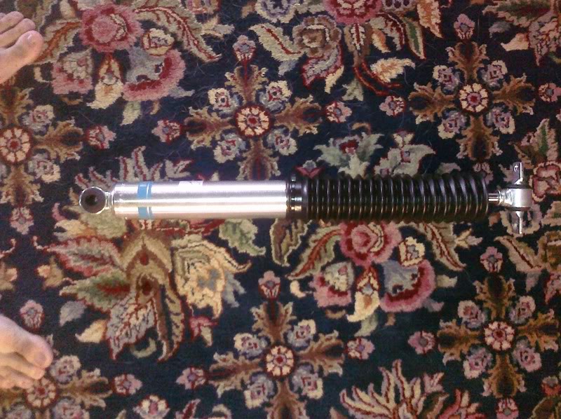

Alright I just got what I'm assuming to be the replacement front shocks. The part numbers on these are
BE5-6526-H7
I called Bilstein and these are supposed to be the right shocks for my truck (these supersede the H5 and H6 of the same model number, or so they say). There's one issue though, I have no idea how these mount. The Bilsteins on the truck now have the shaft that turns into a threaded end so you can thread a nut over the top of a bushing which goes over the frame of the truck. These look like this at the top:

Old Jun 18, 2010 | 04:31 PM
_cashel's Avatar
Joined: Nov 2004
Posts: 1,264
From: Ocala/Orlando, FL
Disregard this last post, I can't read, I was shipped the wrong shocks AGAIN
I was sent BE5 6256 H7 which are a rear set for a Jeep Cherokee lifted 3"
There's no way in hell those will fit the front of an F150 lifted 6"
